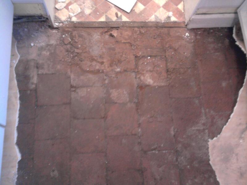

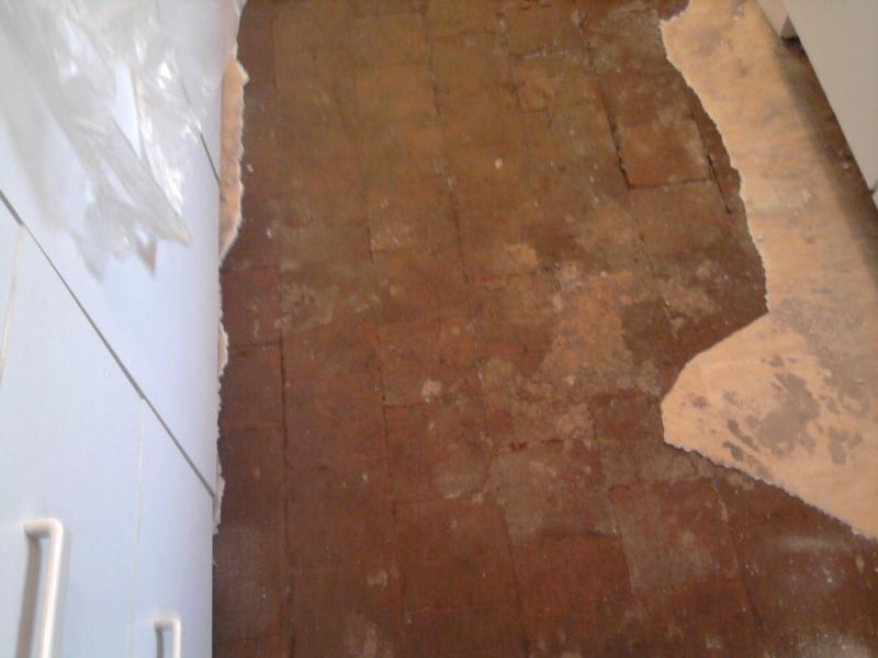

I have just removed the vinyl (lino) from my kitchen floor. It is made of red tiles. As far as I know, they are laid on soil. When I lifted the lino, the underside of the lino and the floor is moist. I removed part of the lino a few weeks ago and that part dried pretty quickly. Is the moisture caused by damp? I am planning on putting some ply down and then lino on top. Would the moisture return if I cover the floor?
What would be best solution of stop the moisture from returning?

The best solution and cheapest would be to clean the tiles and let the floor breathe.
The problem is related to putting vinyl over the top of the tiles, the tiles may not be very porous and the vinyl is not breatheable and the interface between the tiles and the vinyl sweats due to thermal bridging and vapour/condensation becoming trapped between the tiles and the vinyl.
Putting ply down would likely hide the problem for a few years, but it would eventually come back to haunt you!
Next option: If feasible, create a warm floor construction - lay say 50mm of PIR insulation over existing tiles, then vapour barrier and then 18mm moisture resistant t&g chipboard and finish off with floor covering of your choice.
The insulation would stop the thermal bridging occuring which is leading to the condensation problem and the vapour barrier would keep most of the moisture laden air on the warm side of the construction where it will do no harm.
The hardest option would be to dig up the existing floor as already discussed by others and incorporate the warm floor detail (but not quite to the detail that some suggest!)
Or a final option - do some research and see if there are any natural floor finishes that you could use which would allow the floor to breathe, with this in mind you could lay 'new tiles' over the top of the existing.

The dampness you see there is coming up from the tile joints (which is natural) and being trapped by the impermeable lino over time
If damp is a problem, then you can coat the tiles with a liquid DPM or even lay some polythene before your ply and lino

Ideally I would concrete the floor, but I have limited time and also we are not replacing the kitchen units, so I am after a medium term solution.
The lino had become tatty, so just replacing it, to make it look better.
^woody^ I was thinking of putting some Damp proof membrane under the ply. You've said polythene, would using proper Damp proof membrane be better, or could I just use any thick polythene?
