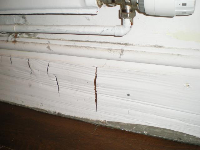

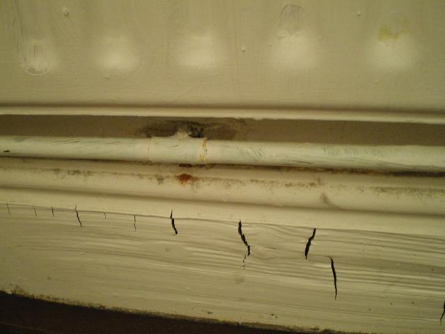

Hi, just discovered what I think is dry rot - the skirting board appears to be splitting:

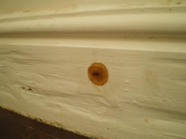

and there is a brown spot further along:

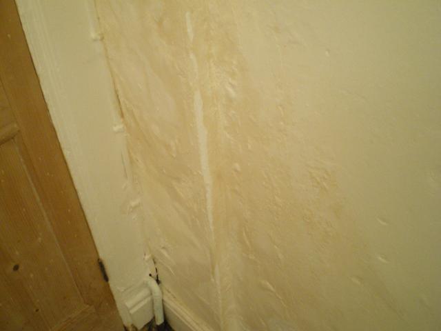

My guess is that this is related to the hopper overflow problems I was experiencing back in January //www.diynot.com/forums/viewtopic.php?t=210626 , because the wall near where that was happening (and in the corner that the skirting is headed for) now looks like this:
[/url]
So - is it Dry Rot? How would I have this remedied? And are there any precautions I should be taking immediately - I don't have any small children in the house but have just acquired a puppy.

Doesn't look like dry rot, timber normally cracks along the grain, white dust cotton wool like fugus will appear, as well a yellowish coloured fugus and the wood will eventual crumble.
Has the wood got damp and dried causing the paint to blister?
The brown spot looks like the knot in the wood has weeped.
I don't think that's dry rot.
Dry rot has a strong musty smell that you would have noticed if it was present. Dry rot also needs a continuous source of moisture in order to spread, however it does dry out the timber causing it to lose strength and eventually to crumble.
If you want to be sure, take up your carpet and check your floorboards for the cotton wool-like spores that Prentice Boy was describing.

The skirtings were repainted a couple of years ago following an underfloor central heating plumbing leak, so I guess they would have got damp then, and now thay are dried out it's made the damage.
I'll just give them a rub down and a fresh coat of paint, then keep an eye on them I guess.

probably wet rot and penetrating damp on that wall by the door - New pipework needed - like I said back when ;)
mmmmmm gently take the skirting off,it will probably fall apart.
be prepared for the worst :( both wet rot and dry rot do cuboidal cracking.

That's asking for trouble. The brown marks are you fixings rusting. You could have a nightmare developing under the floor unseen until it's too late. I'd get the skirting off now and see what's lurking behind them.

You're having a laugh aren't ya? That timber's had it. It wants ripping off and binning. It's rotten to the core, I can see that from here. New timber -and make sure it's vac treated, or at the very least treat the reverse face before fixing.

I would suggest that you get the specialists out - its hard to determine what type of rot you have, I would hedge my bet on 'dry rot' but there may be a small chance its the effect of wet rot.
Wet rot is simple to cure, once the source of the water/moisture is stopped the rot stops and all that is generally required are local repairs. Therefore in your situation as you have solved the leak then the rot should not be spreading.
Dry rot is a totally different animal (and you should get a specialist out if the timber decay has been spreading since you solved the leak.
Generally speaking to become established dry rot does not need water, all it needs is moisture e.g. the moisture contained in the timber will be sufficient and fungal growth is helped by humid/stale conditions (lack of ventilation in floor voids being a prime example) think of mushrooms - after all it is a fungus. Once established dry rot can survive on the moisture in the timber and/or surrounding air - conditions no longer need to be humid. Dry rot is an absolute nightmare, if not caught early enough it can travel through brickwork, between the brickwork and plaster, across pipework and any other surface it comes into contact with to reach its next supply of wood.

Looking at the pics there is a possibility of dry rot but best to get it checked out by a fungal decay specialist - either way the source of the moisture into the building needs to be stopped otherwise the problems will come back.
