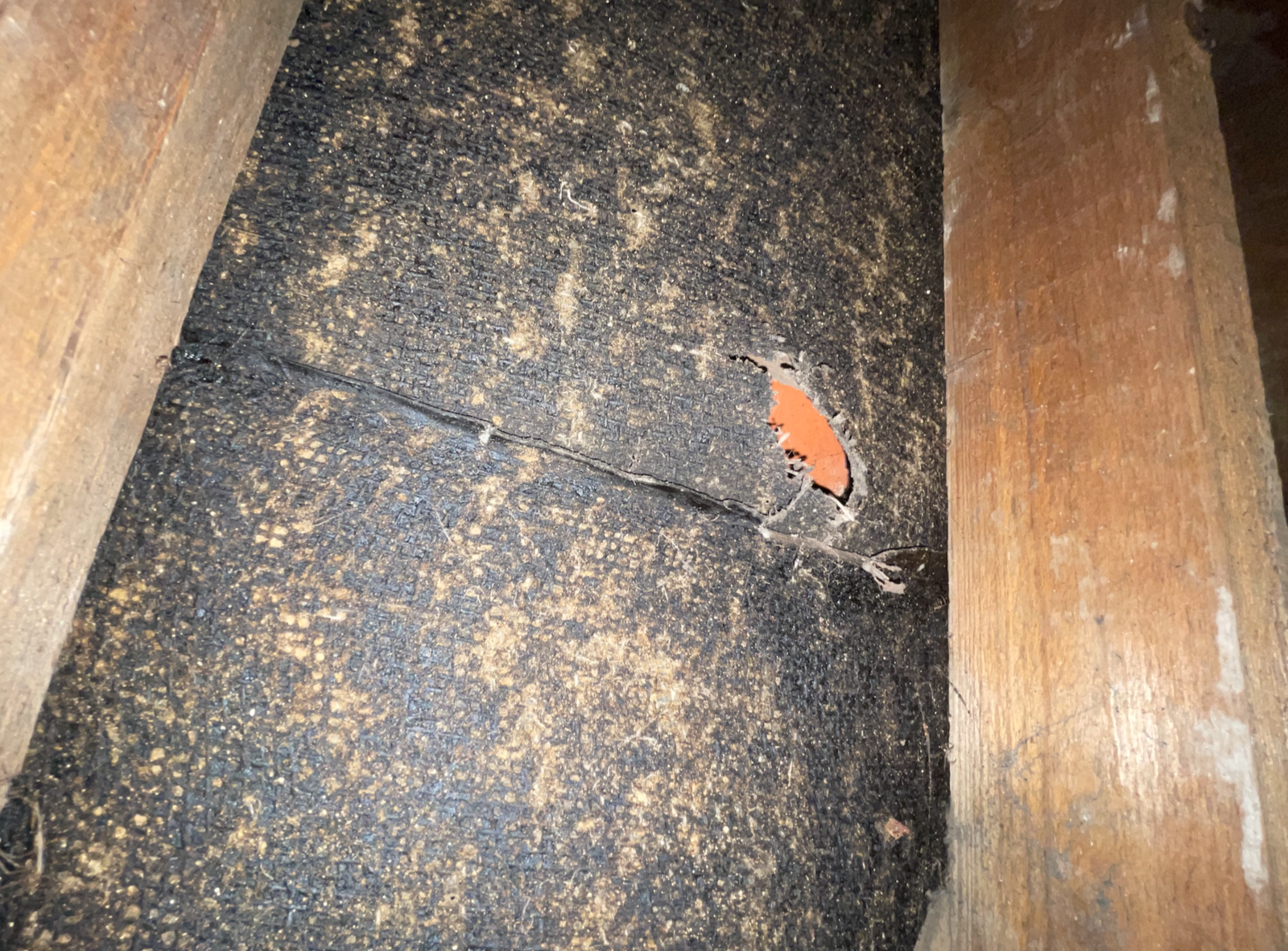

Hey folks,

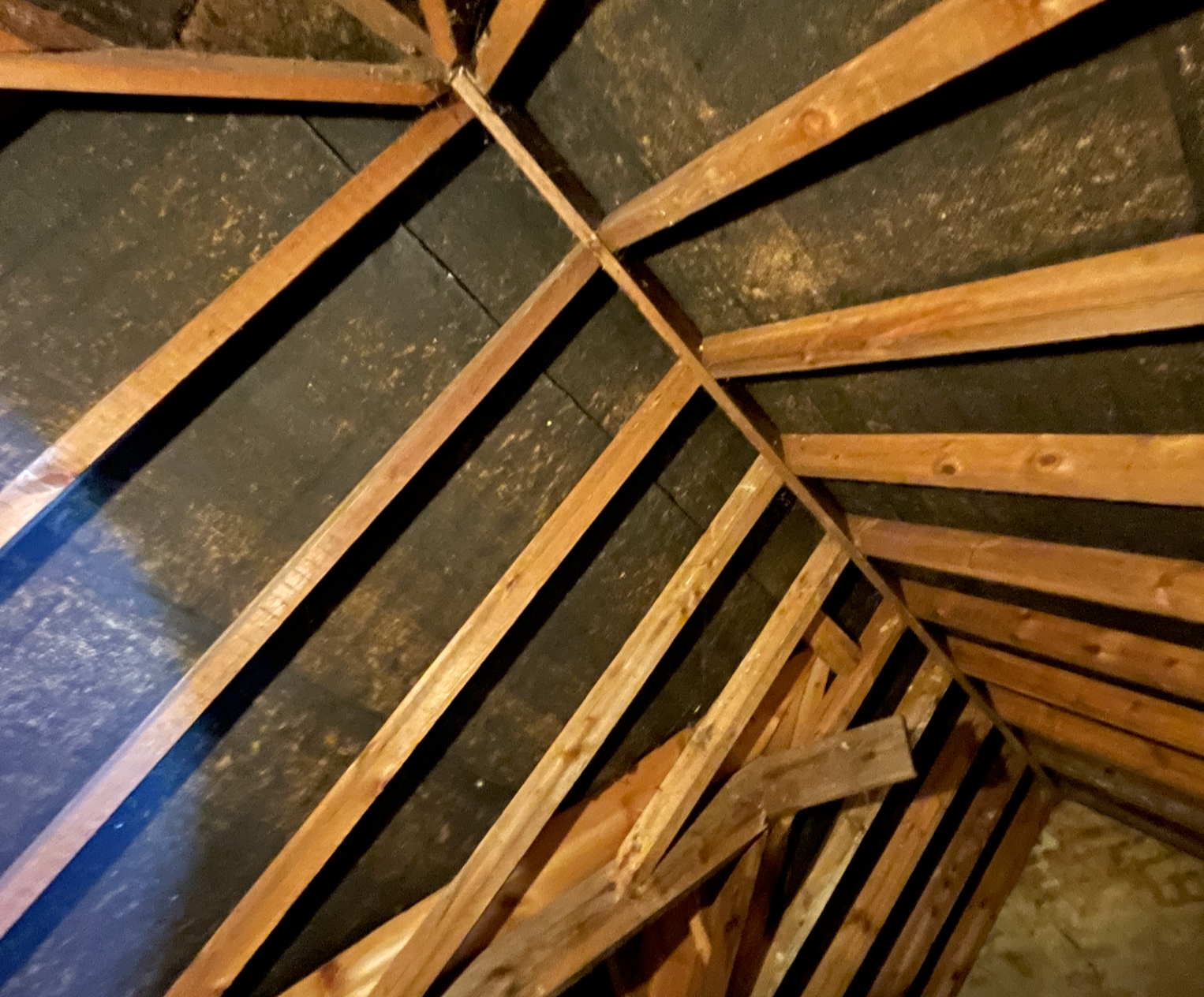

Hoping for some advice, please. I've offered on a 1930s built property, and as far as I can tell from the outside, no tile replacement has been done (judging by the other houses on the street - most are showing the same patina/colouring on tiles)
Now, when I went into the loft, there was quite a bit of orange dust. I didn't touch it or rub it between my fingers, but it's pretty vivid in colour, so I half suspect it's roof tile dust as opposed to mould. There hasn't been any works done in the loft for over ten years I'm told.
The felt in the loft is pretty knackered - I've read that the felt is only really a secondary barrier against tile failure, as opposed to a defence for rain etc.
Could anyone please suggest any advice on:
If the loft felt replaceable leaving the tiles in-situ? i.e they don't need to be removed to do this job and it can be done from the loft, rather than outside the property?
Is the orange dust anything to be concerned about? It's not a sign of tile degredation or they're disintegrating into dust? My theory is that the orange dust is simpyl from the tiles and is getting blow in by the wind o_O
Any advice gratefully received. Thank you
No you can"t replace the felt without removing the tiles (and battens which the tiles fix to). That felt doesn't look bad anyway, check around for any evidence of water on the floor.
Have a good look at the timbers, brush any cobwebs, dust etc off and see if there's woodworm in the rafters
Thanks - there are a couple of areas where it's got a hole in it. Not sure if they can (or should) be patched up internally if the whole thing can't be replaced?
Will get a closer look at the timbers etc - I couldn't see any damp from looking. The orange dust is curious but unsure if it's also nothing to worry about.
Cheers

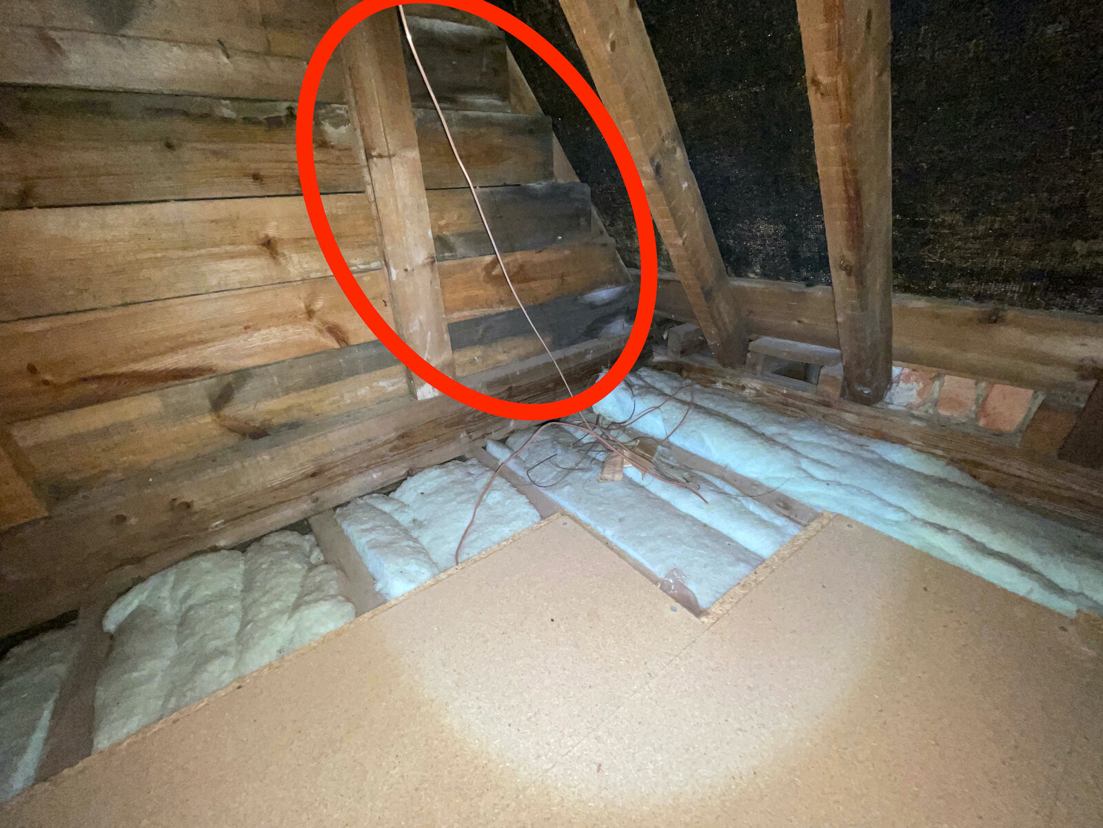

That is really concerning - on further look at this photo perhaps it isn't tile dust I'm looking at

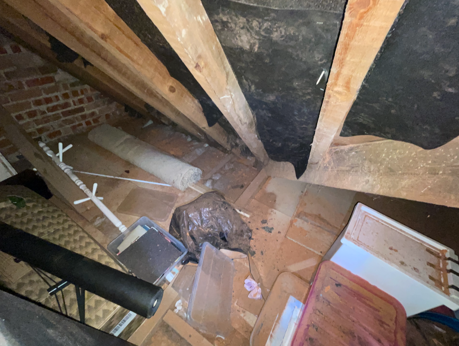

And one more here which doesn't look great...
Difficulty is now knowing what a typical cost may be for sorting this, if it's £2k or £20k :unsure:

Mmm. Not an expert but cost & work required will depend on how much damage has been done to the timbers (assuming it is dry rot, that was a handy link from @JohnD .
Def cause for concern, worst case would be full reroof & possibly new joists for the ceiling below. Need a conversation with the vendors (are they prepared to accept a reduced offer if it turns out to be a problem) and see how much it'll cost you to get the roof surveyed by someone who knows timber (not sure a structural survey would be suitable, they'll just tell you to get an expert report)

The red dust is probably from the tiles.
I've seen nothing to suggest dry rot.
If you rub the red dust between your fingers you should see it's clay dust . This could mean the tiles have started to fail.

The dust does look consistent with the tiles, but the area at the gable end with blackened wood with white patches does worry me a little bit.
