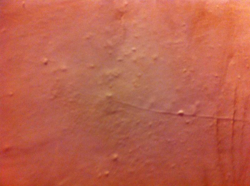

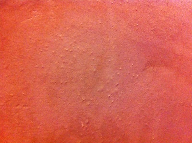

Have just had my artex ceilings plastered, I have noticed that some have small bobbles on this, see picture. Is this normal and will they show when painted.
Thanks for your help.
Very bad plastering. It looks to me as if he's put it on, maybe went over it a couple of times (debatable), then went home before it had properly gone off, hence the blisters/pimples,/marks. Too much of a rush to finiish the job i'd say. Get him back to do it properly.
On second thought, get someone else in, and blacken the other one's name as a "rubbish plasterer".
