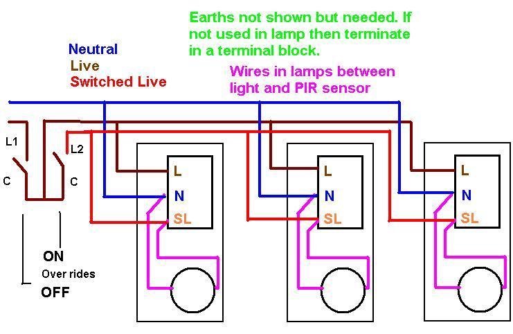

What did you have in mind. One or many PIRs. One or many lights?
To do that, you'll have to buy three PIRs and three separate lights.
These days, most of the lights with integrated PIRs do not support interconnection as the internal connections are not available.
buy a decent PIR. These work well IMO
https://www.tlc-direct.co.uk/Products/STIS1B.html
Connect them up per the following.
many thanks.
My first step would be to replace the existing light fitting with a junction box and then extend from there similar to what you have provided in the sketch.
