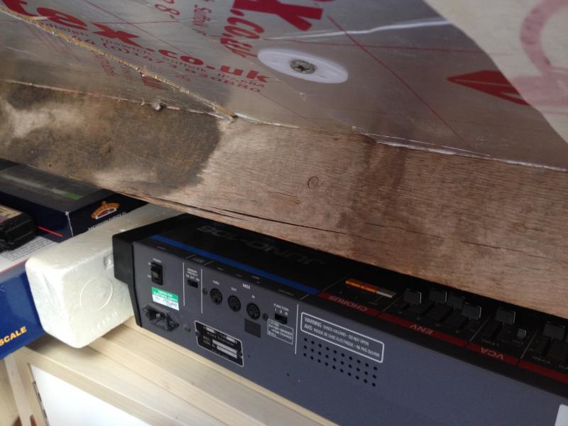

I am about to complete the last stages of our attic conversion which involves mounting 6x3 sheets of 9.5mm tapered drywall on to the rafters.
I just want to check that the purlins are up to the job of taking the load. They are 6.5 x 3 inch and span the entire attic space 3.5m.
The house is a Victorian terrace.

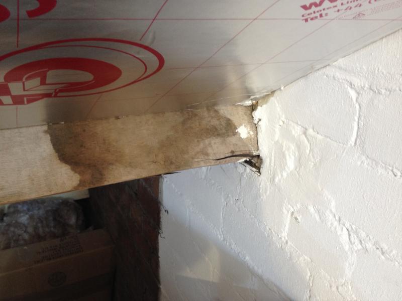

There is some slight bowing in the roof which seems normal looking at similar houses on our road but there are a couple of cracks in one purlin, pictured. (The Purlins are partially obscured by the insulation)
Do I need to look at reinforcing them before adding the weight of the plasterboard?
They should be fine, yes; those cracks are nothing to worry about.
Presumably you have steels installed to take the new floor? If so they should be quite close to the purlins in the vertical plane. You can consider bracing the purlins with vertical struts to the floor just to be extra safe.

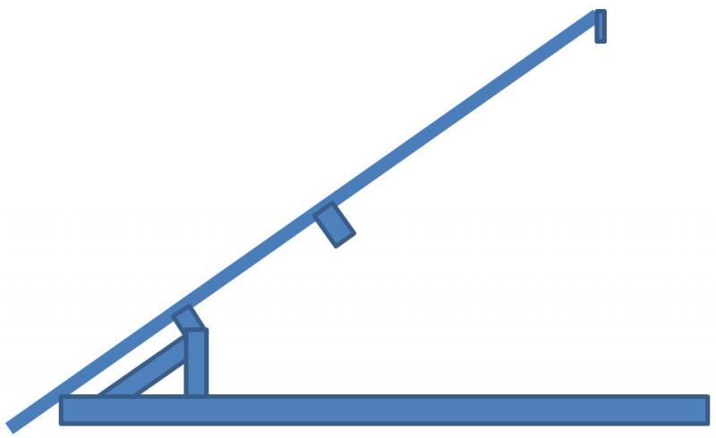

I was thinking more of putting a smaller purlin about a meter down the slope bracing the rafters with the new floor. This enables the space immediately under the existing purlin to be used for flexible storage.
Shoule I be using joist hangers to fix the additional purling to the brickwork either side or will the combined strength of the new structure be sufficient without them?
Diagram attached.
The floor joists span from outer walls to two inner supporting walls.

Shoule I be using joist hangers to fix the additional purling to the brickwork either side or will the combined strength of the new structure be sufficient without them?.
I'd definitely be transferring the weight onto the brickwork somehow, yes. Personally I'd try to get the ends of the timbers set into the walls. Not the easiest of jobs, I know.
Building control reply was simple. None of the attic conversions signed off on this building type required additional strengthening. It's fine as it is and can support plasterboard insulation and skim.
However he's also said that using the lower vertical struts to bind the rafters to the joist can only be a good thing.
All looking good then. Final question is a general woodwork one. Should I worry about screwing the lower purlin into the rafters? Will the screws affect the structural strength of the rafters?
There you go :) If anything, what you're doing will strengthen the entire structure.
I'd try to spike some big screws through your new purlin into the rafters, yes.
- get your new purlin in place (joist hangers to the brickwork will, no doubt, suffice).
- Use a sharp wood bit to pre-drill your purlin to take the 6" screw or whatever you're using.
- Good luck ;)
