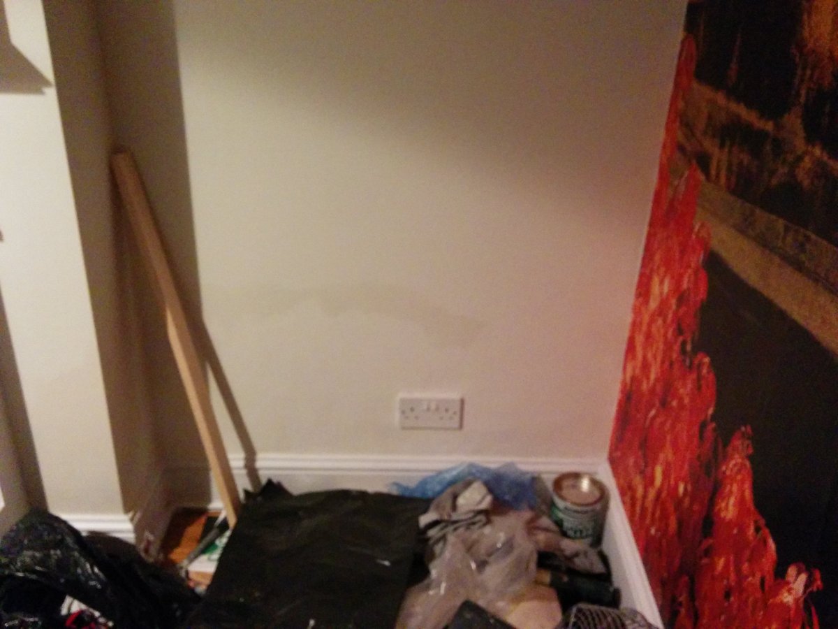

Not sure if there was a better place to post this.
I just had my 3 bedroom house redecorated and soon after doing that I noticed water marks/stains in 3 different places on the ground floor.

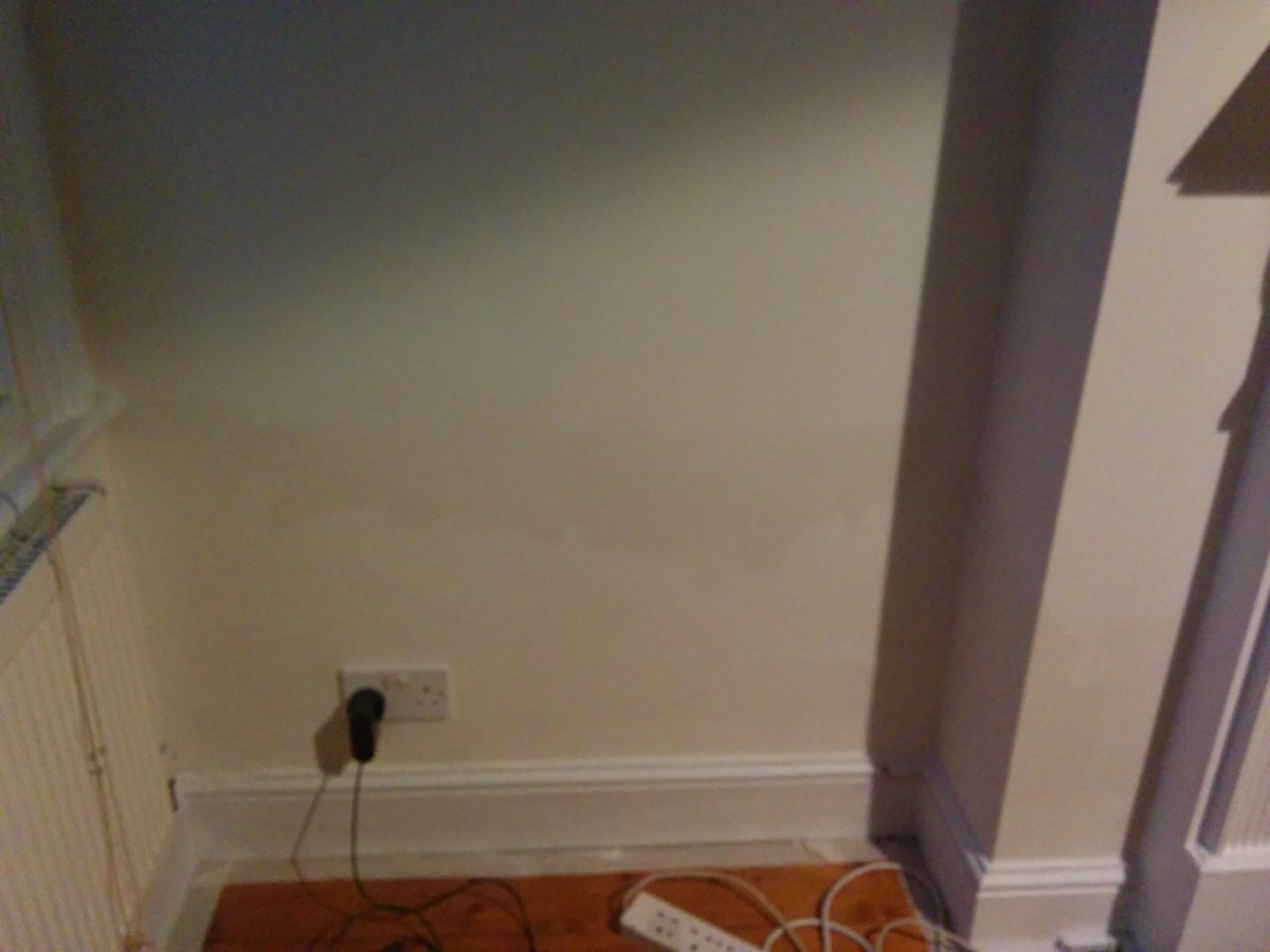

2 marks are in the same room, left and right of chimney breast

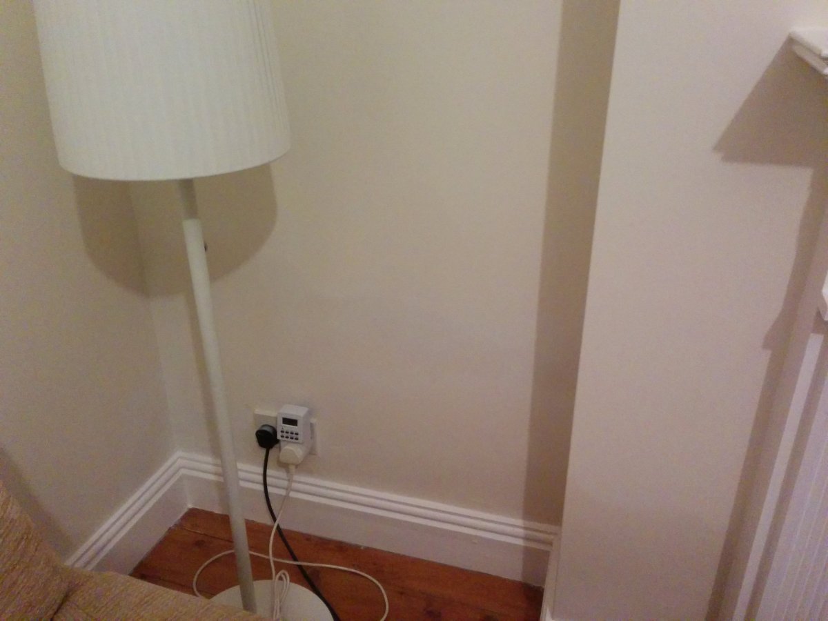

And the other mark is in the living room left of the chimney breast.
Dining room left of chimney breast - u can see water marks on the chimney breast too
Dining room right of chimney breast - the wall that has wallpaper is the wall separating the living room and the dining room
Living room left of chimney breast - left of the lampshade it's the wall of the dining room.

All 3 marks seem consistent with one another - and the first picture (left of the chimney breast in dining room - there's no shed behind that).
