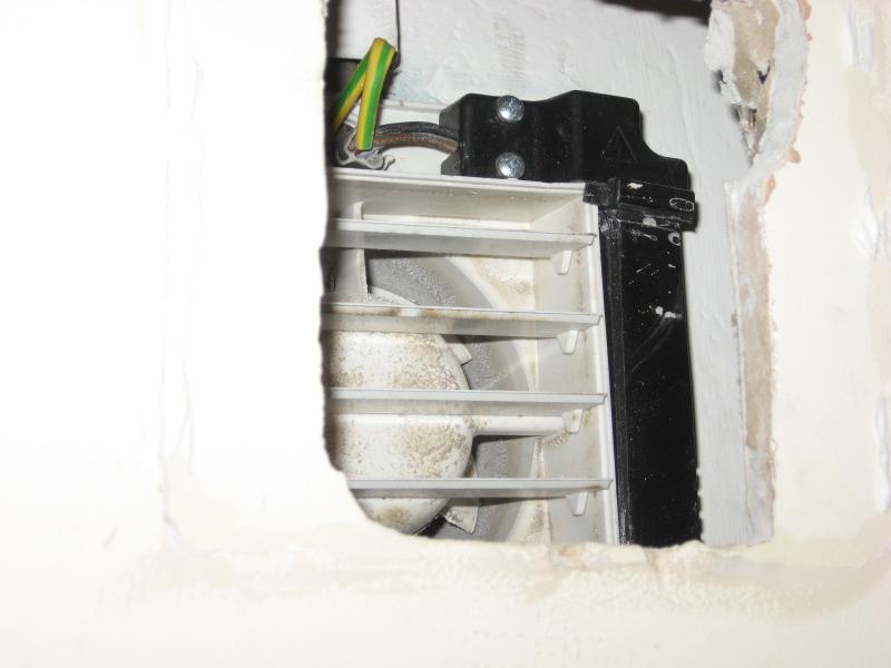

I am having some renovations done an electrician working in my house has covered the mains wire running down the wall but just left it exposed over the skirting board the into the floor. Is this safe or even legal?
THe bathroom has been framed and plasterboarded this means the pipe for extractor fan no longer reaches the internal wall the cover has just been glued onto the new wall will this be good enough
If you mean that the extractor fan now vents into the void behind the plasterboard then absolutely not.

If the cable is in trunking for the whole run then that would usually be adequate, but pictures would help us to be sure.
I would suggest you don't use the bathroom fan, as unless the spigot on the internal fan/grille is inserted properly into the ducting through the wall, it's very likely that condensate will drip down behind your brand new plasterboard and damage it.

It seems from your picture that the actual fan itself has been covered up with plasterboard, and from what you say a grille has been stuck onto the plasterboard. Since you mention the word 'wall', I can only assume this fan is now inaccessible.

I can't quite figure out what's going on with the fan, but as already mentioned the wiring needs to be accessible and the ducting continuous, ie if the wall was being battened out it would have been better to take the fan off the wall, extend or replace the ducting and fix the fan to the new inside of the wall. That way the fan could simply be unscrewed from the wall to allow for maintenance.
