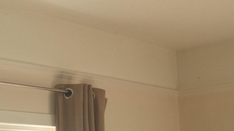

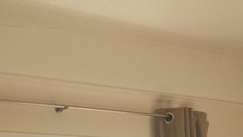

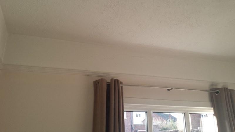

Hi,
What was just a ridge in our front room has now turned into a long crack. I have checked outside and there appears to be no exact crack the other side on the render but there are other long spider cracks.
The house is 90 years old. I have been told that houses move but this crack looks quite angry. Should I be worried?

I notice that someone has replaced the proper window with one made from plastic - it could be that the brickwork above is no longer properly supported.

No you shouldn't be worried. Cracks in 90 year old plaster mean nothing. If you fancy it next time you decorate hack the offending plaster off and have a look at the structure underneath. And don't worry about tony - he's just in mood because his house is falling down.

The PVC frame in the swept head opening is set well back, so its possible that the original wood frame was not supporting the outer masonry skin? Which implies that there might be a lintel or brick arch.

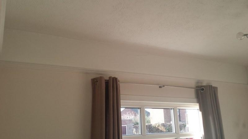

Before decorating, why not remove the 1" x 5" pencil round piece of trim below the curtain rail and post a pic of what you expose - there's possibly a wood lintel behnd it? Cut the paint to cleanly release the trim.

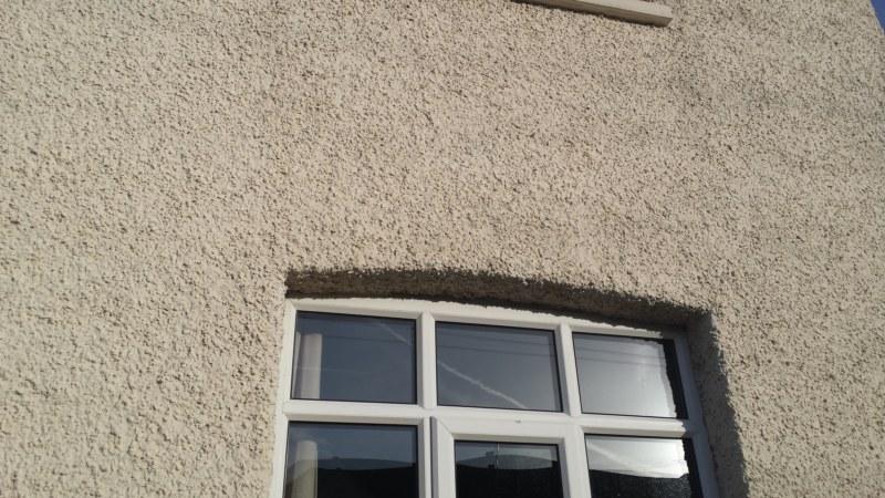

The final pic shows render with a Tyrolean application over: render is, and was, often applied to cover defects.

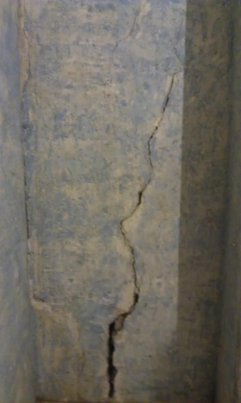

There is also a high S&C plinth thats touching the ground. Cut back the last 50mm of plinth that touch the ground.
The plinth appears to be projecting (ledging) beyond the Tyrolean, if so, water could be penetrating behind the plinth.
Repairs have been made to the plinth - does the boundary wall butt up to the plinth?

My two cents is that the cracking is, and was, thermal movement.
It might be worth your while to put a spirit level on your floors (both ways) at that wall?
