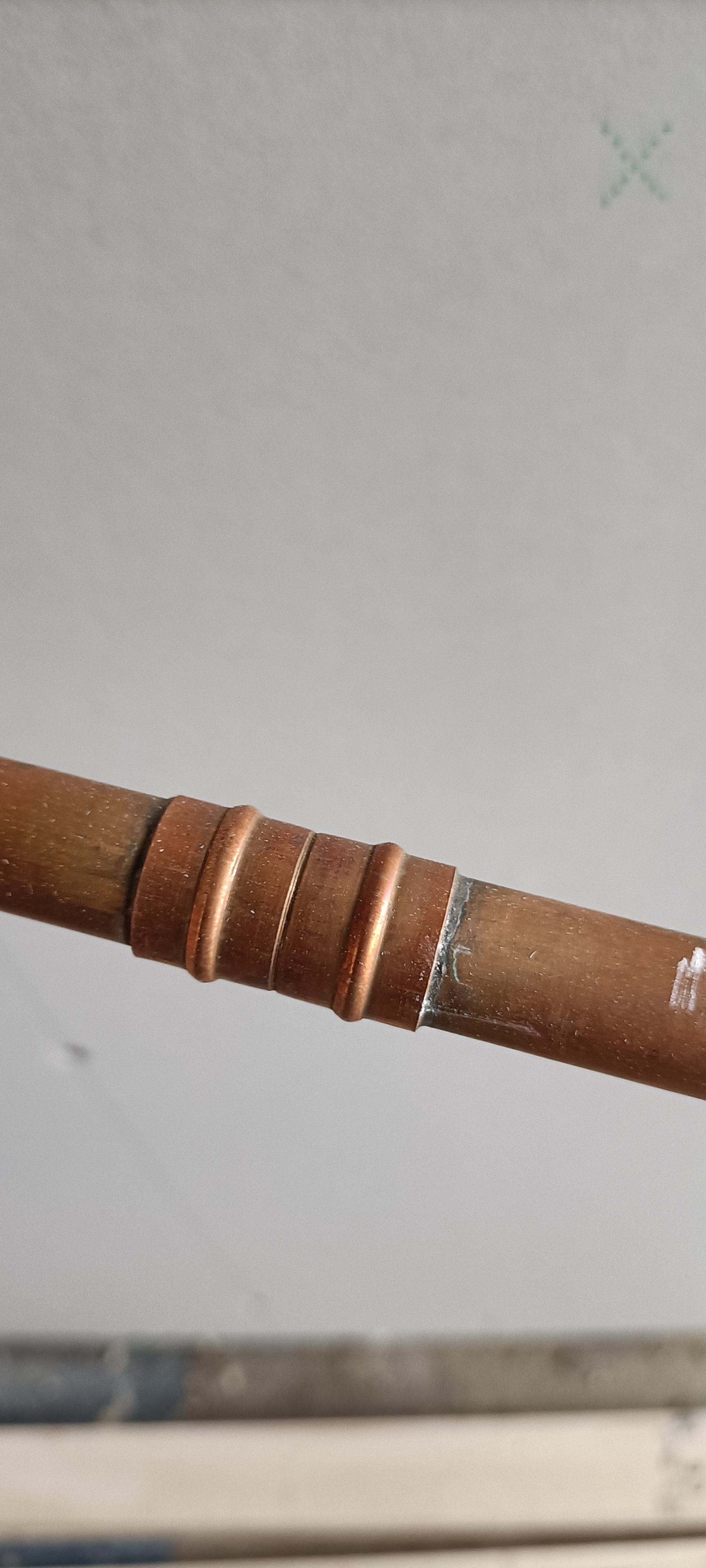

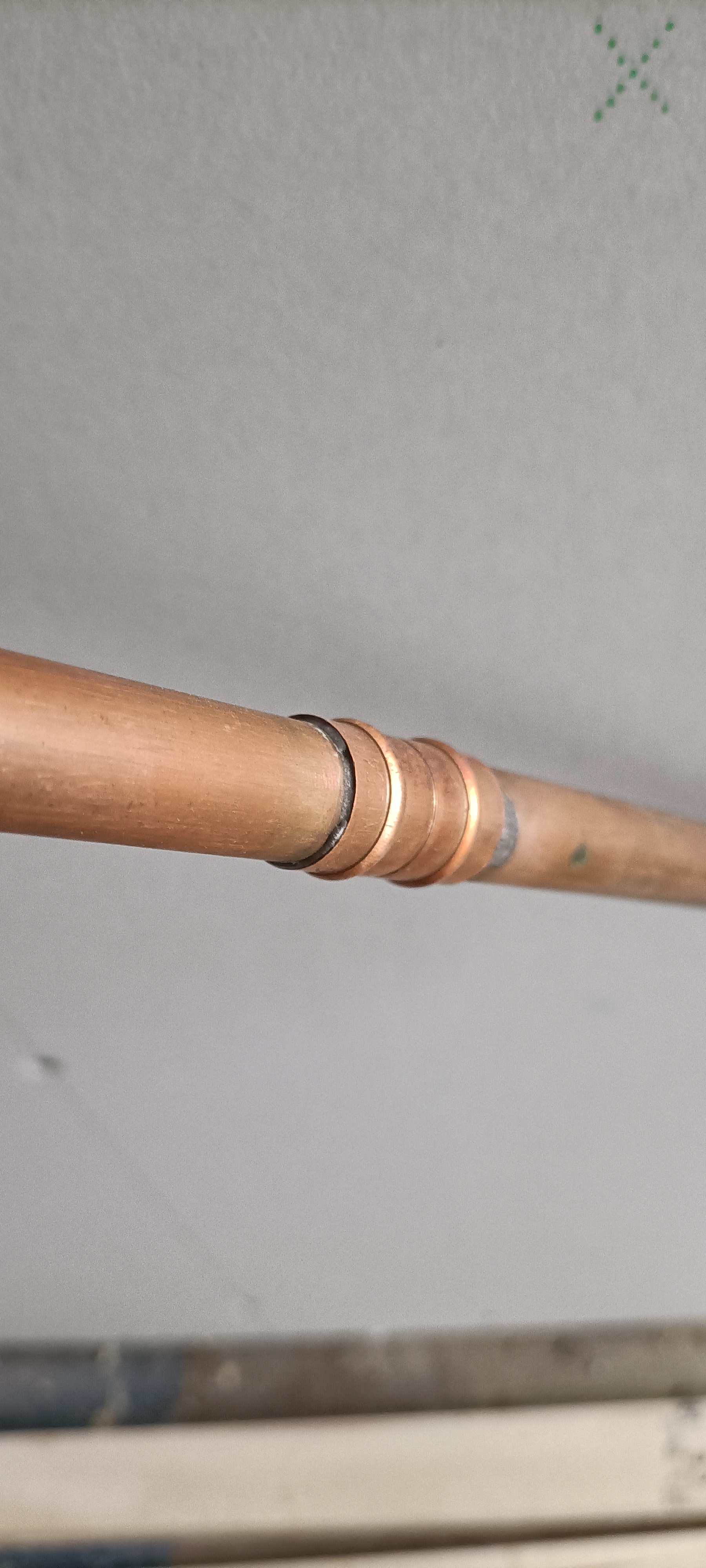

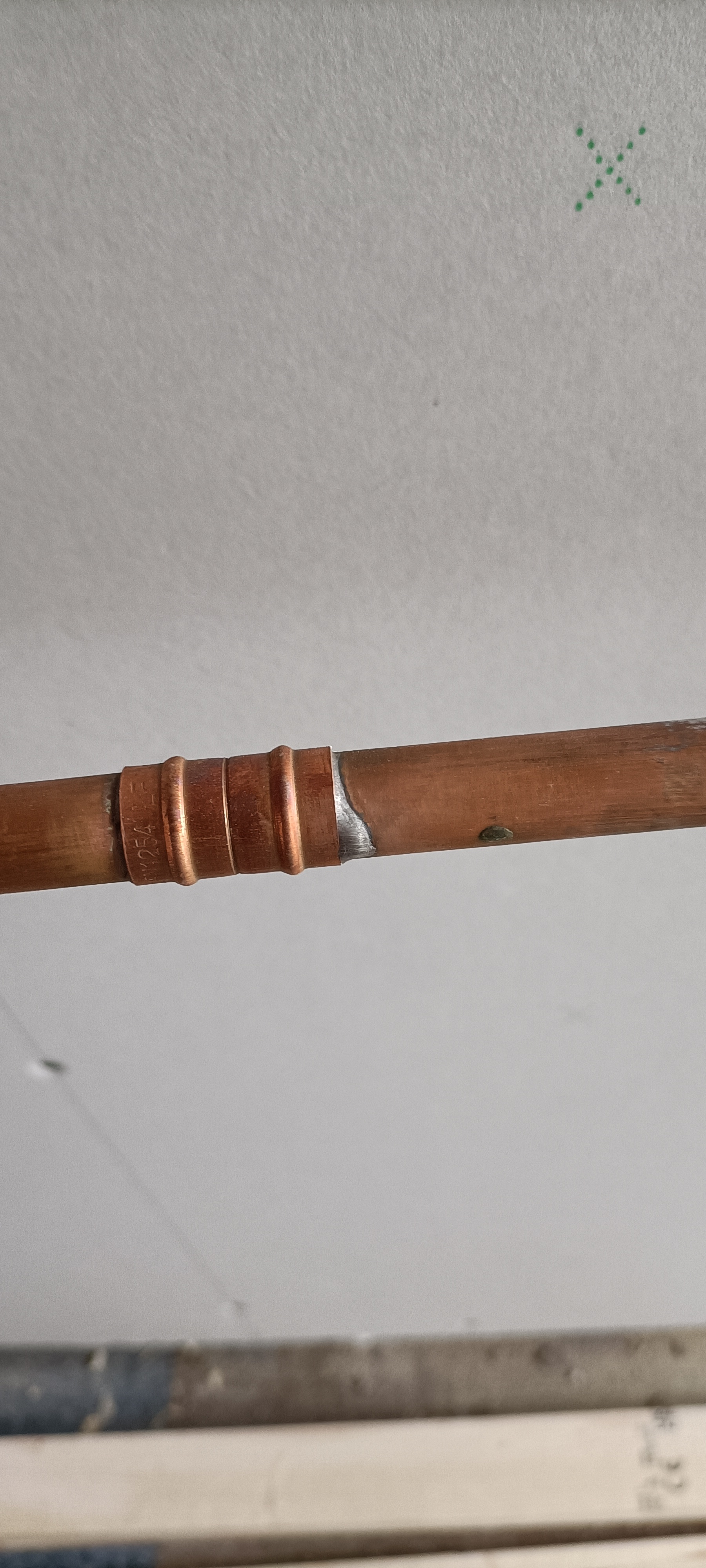

Gave this a go the other day, i think the joint looks ok, would appreciate some feedback if possible?
Do the joints look over/underheated? Does it look like the solder goes all the way enough, or should i have held the flame a moment longer? I also assume where the solder has come out too much, this is just because i didn't wipe the excess flux off enough?
Many thanks
1. First two pictures (RHS of joint, ...728, ...723) look fine.
2. Last picture (LHS of joint, ...718). Almost certainly fine, but I'd prefer to see a more distinct solder ring at the edge of the fitting. Did you wipe it with a damp cloth while still hot?
Hi, thanks for your reply. Good to know they look ok - even if a bit too much solder, i assume its because i had a bit too much flux, or is it something else?
I didn't wipe the damp cloth at all - once cool i gave it a quick polish with red scourer, and that was it. I think i should have held the heat on for a few seconds longer on this bit?

You get guides saying only to heat the pipe and not the fitting. I heat both and have never had a problem. The blow torch you're showing will be fine for 15mm in decent temperatures but will struggle in freezing ones. In my experience you want to get the heat on there as fast as possible. Just my tuppence.
