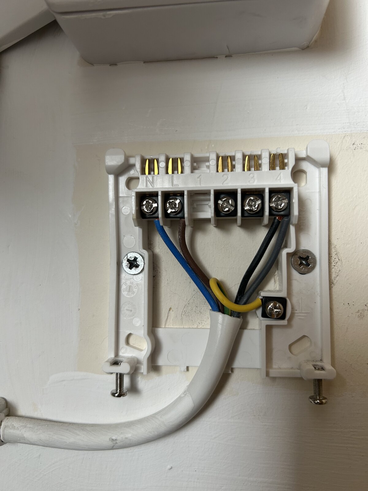

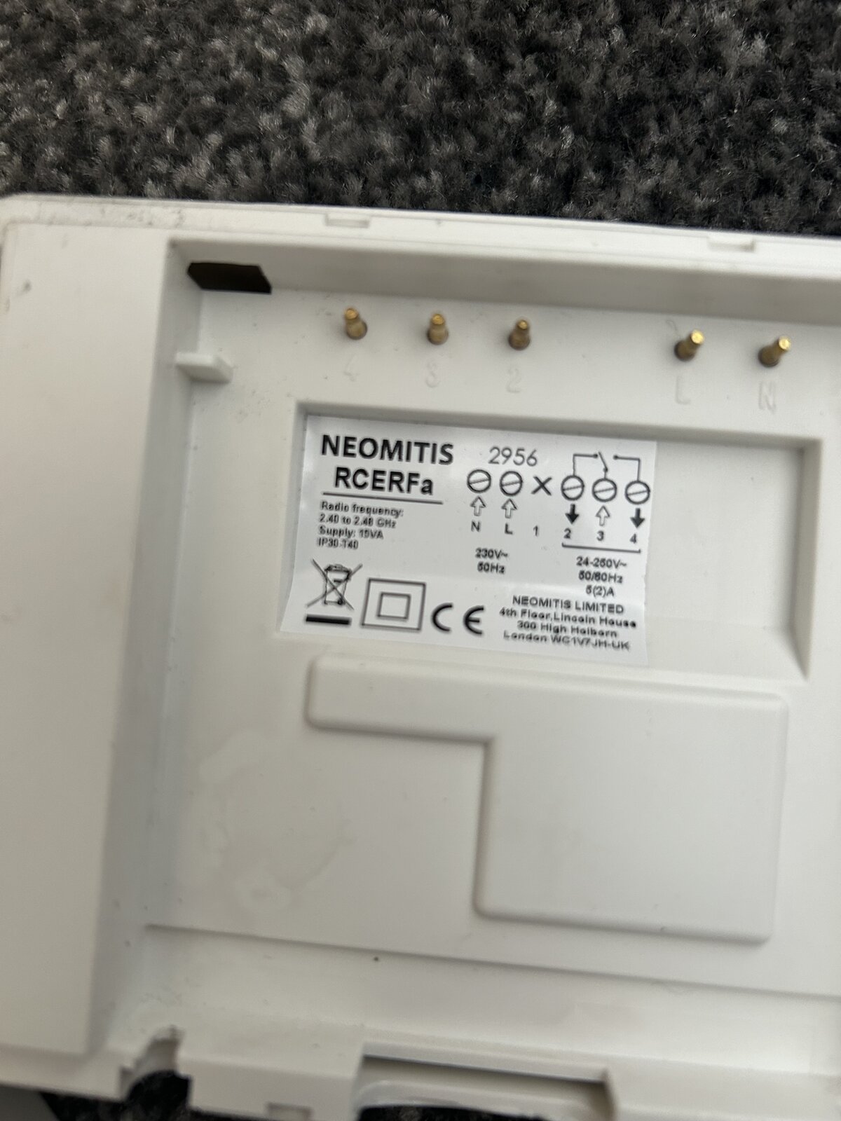

Hi, I recently moved into a property and the Neomitis thermostat has absolutely no affect on the boiler, it is sync’d with the receiver and paired but whenever I turn up the heating on the thermostat the boiler does nothing. I have checked the wiring on the receiver and I’m sure this is incorrect, the black and grey shouldn’t both be in 4?
The grey and black wires should be connected into terminals 3 and 4.
But as the thermostat has been bridged out like that, it suggests something may have been wrong with it in the first place.
Any C/H timer on the boiler should be set to permanently on, for the thermostat to take control.
So I just moved black into position 3 and is now working as it should, perhaps just bad installation.
