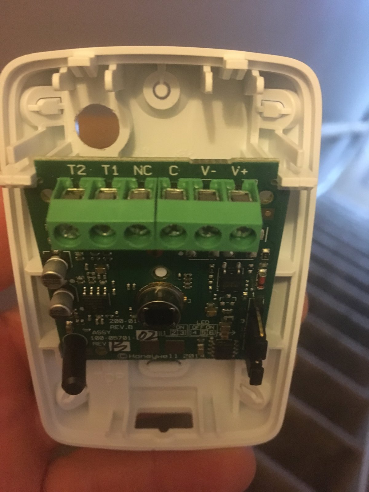

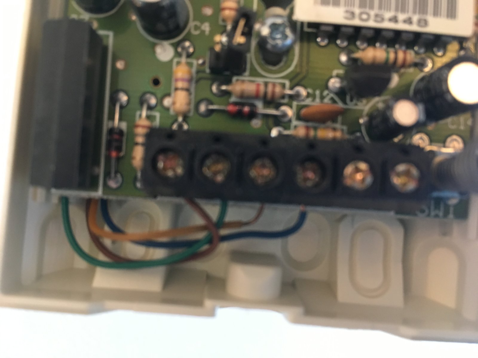

Anyone help me with the replacement wiring for a swapout on my new PIR sensor. My original has only the marked terminals : A B C D E F, only 4 wires used (A-D).
Tried various combinations on the new marked T2 T1 NC C V- V+ but keeps coming up fault on keypad panel.

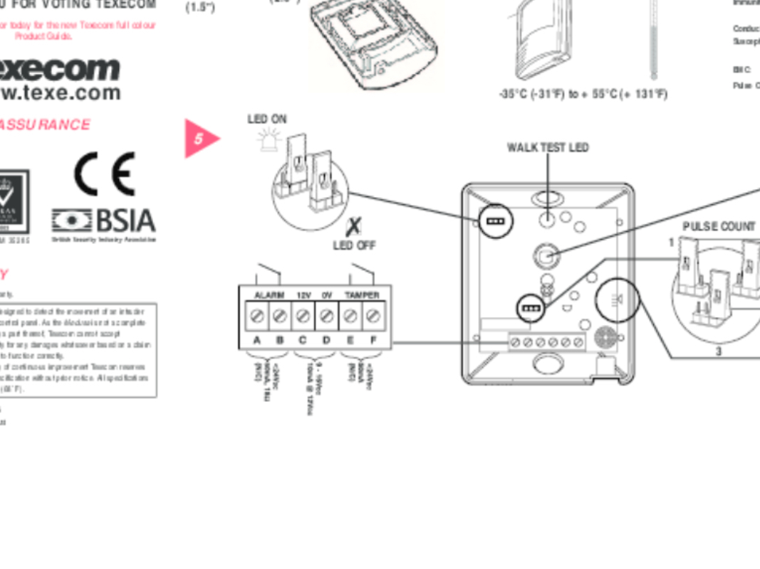

Sounds like an old Texecom pir
A and B alarm
C 12v
D 0v
Hi,
Thanks for the reply. I think it is indeed what you said. How do I transfer the colours to the new one? I’ll attach pic of old and new.
