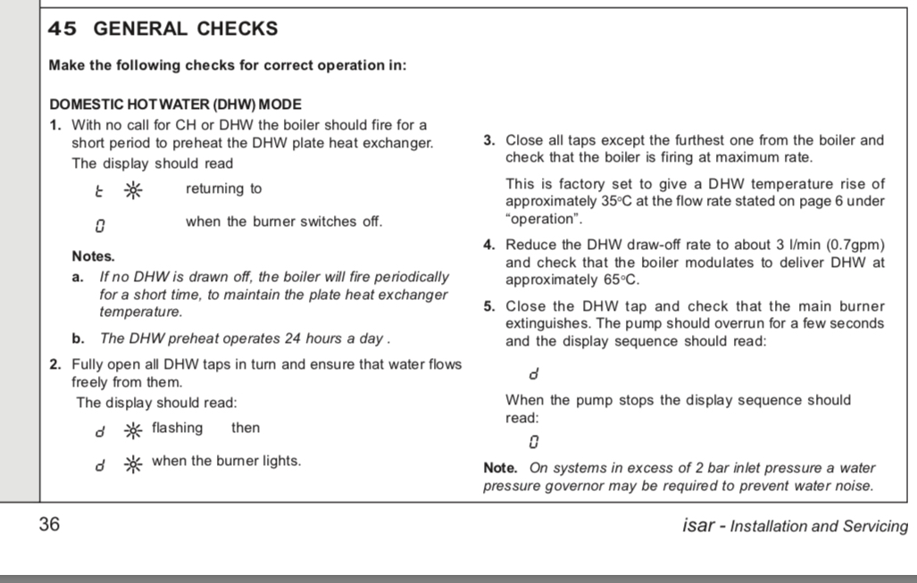

Hi there,
I moved to London last year as due to work.
I have a house up north, it has an isar HE30 combi boiler, fitted by warmfront scheme 15 years ago. It has preheated hot water tank for instant hot water.
Since I moved to London, the boiler keeps the preheated tank hot all the time which is very wasteful to gas and bad for environmental. I looked in the manual, nothing say how to turn off/disable the preheated hot water tank?
HOW? I looked EVERYWHERE on net. Nothing!
How can I turn off the preheated hot water tank please?
Thank you
Had a look, it appears you can’t?
