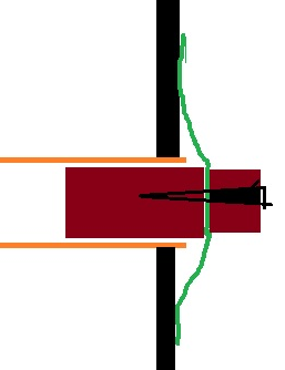

Alternatively you might be able to plug the end of the pipe in the cold water tank with a mushroom.
Wooden dowel that is a loose fit in the pipe and a disc of soft rubber or flexible plastic. When the tap is turned on the water pressure will press the disc against the wall of the tank.
