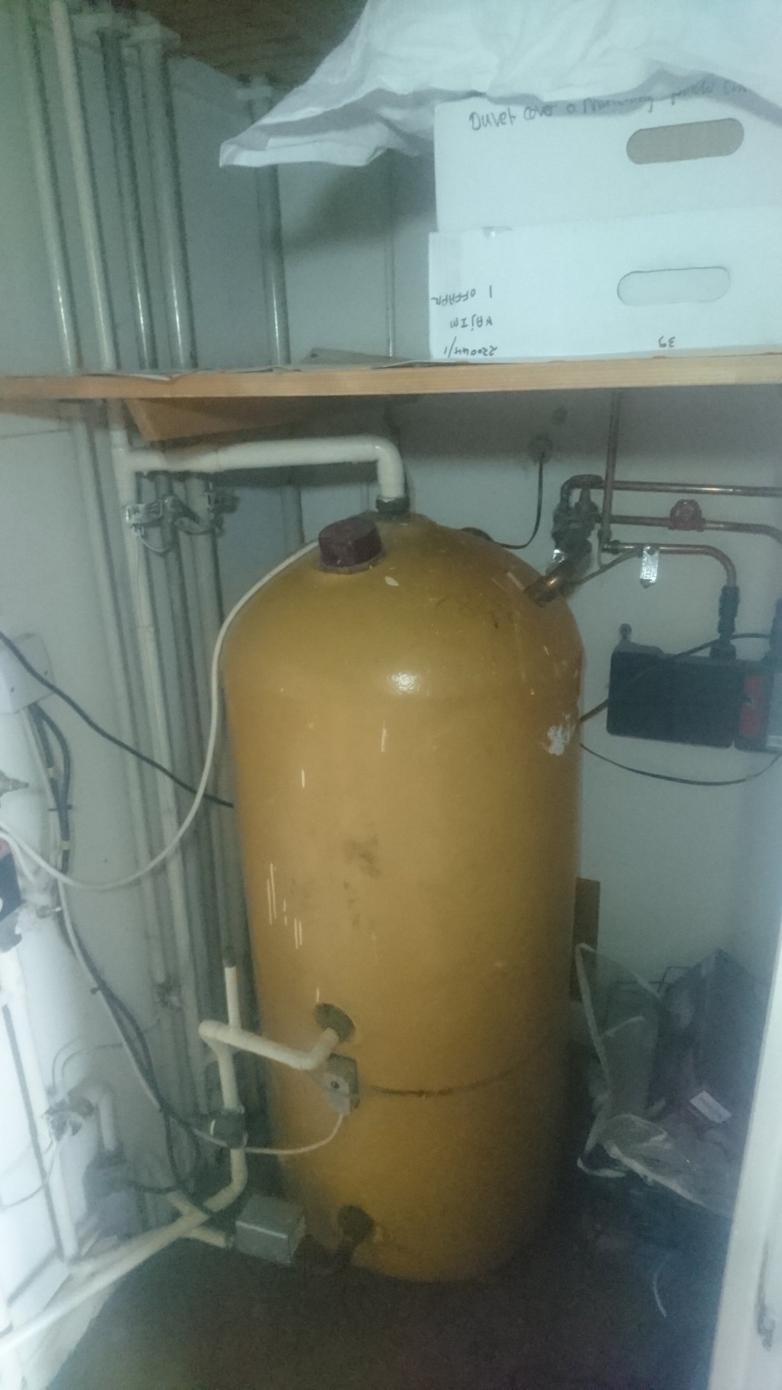

The down stairs bathroom in soon to replace does not have any isolating valves on the pipe work for the taps/cold feed to the toilet etc so I need to isolate these before going about any work.
HW
Ive got a conventional HW cylinder like this.
There are no gate valves/stop cocks entering or leaving the tank but there is a valve on the header tank in the loft that supplies the cylinder.
If I shut off the valve on the header tank will I also need to empty or drain off the HW cylinder before disconnecting the hot feed at the downstairs tap?
(not sure if the cylinder works by displacement of water or just by gravity so wanted to check first!)

Turn off the main stopcock and drain the tanks in the loft, when they are empty the hot water will also stop , then you can change what you like and fit isolators to your downstairs toilet, don't try and loosen old gatevalves , replace them with lever valves.
