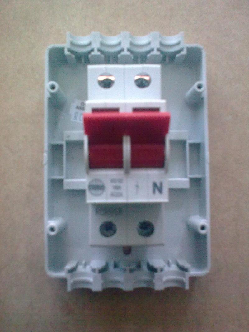

I fit between 3 and 4 isolators a week and have never known one to cause a problem
View media item 8401

Please note that the damage is on the out going side of the isolator probably caused by the electrician not tightening the terminals properly. Everything before the isolator looks ok.
To just say they are a waste of time does not make sense. They are no different to any other joint within the electrical instalation, if the terminal is overloaded or left loose, it will fail.
They are a joint which does not need to be there.
If it wasn't there it can not fail.
Simple.

So did those isolators fail like that because they are isolators?
I can't work out why they should be any more prone to failure than, for example, CU incomers (to which some bear a spookily close resemblance), or Henley blocks.
