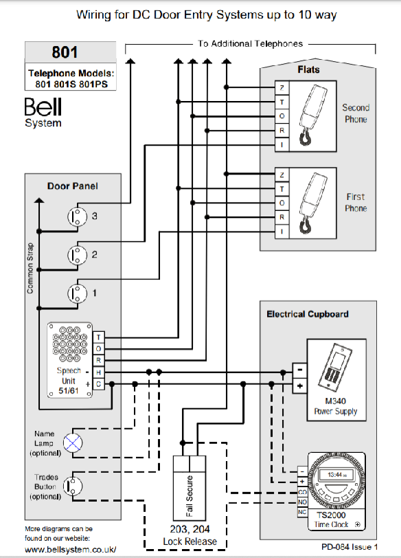

I have recently renovated my flat and changed the entry phone. This phone was moved around a lot to accommodate the works going on. All was working totally fine, and I have been left with a phone that doesn't buzz when someone is at the door, but you can press the button to let them in.
On opening up the phone this is what I have, is there a simple fix for this? Any advice would be greatly appreciated.
