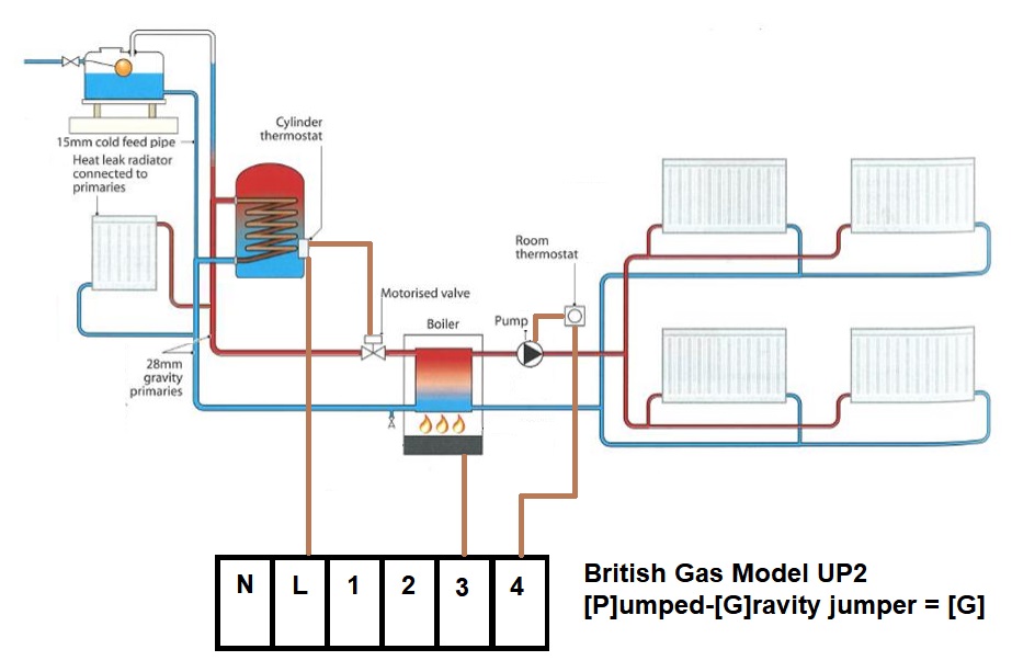

I've spent quite a few hours trying to fathom how my boiler is configured.
At first sight it appears to have all of the components of a c-plan system, 28mm 2 port valve, hot water cylinder thermostat, central heating pump and room thermostat.

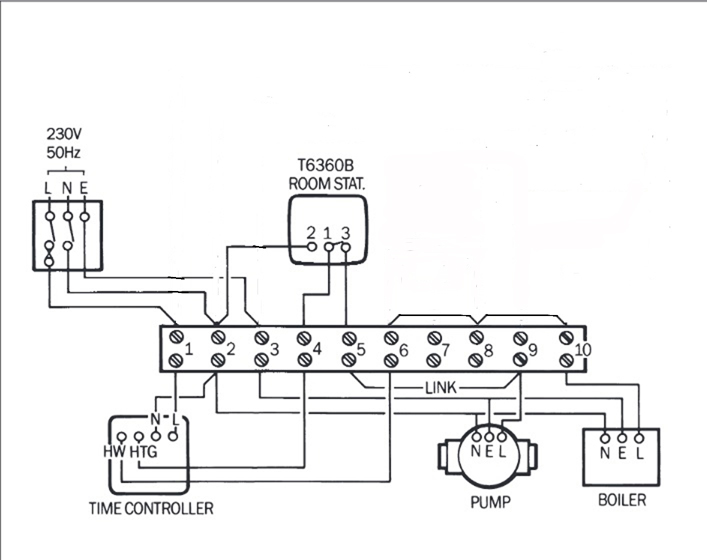

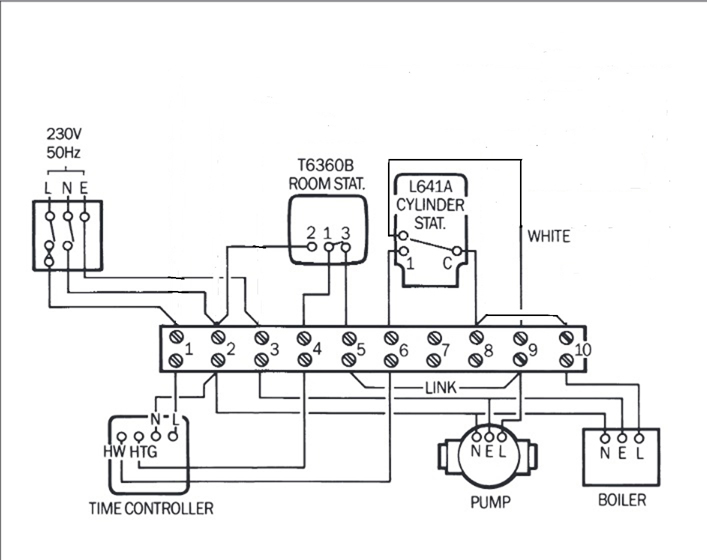

Firstly the controller, a British Gas UP2 (Drayton 722 equivalent possibly) has the P-G jumper set to G for Gravity, rather than P for pumped. This means that hot water is always demanded (connection 3) when the heating is on (connection 4), I would like to control heating and hot water independently.
The wiring is then done in a very strange way, there is a constant live through the hot water cylinder thermostat to the 28mm 2port valve, so whenever the cylinder is below temp the valve is open, irrespective of boiler operation (the 3 wires for the microswitch have been cut short and are not used). Connection 3 (HW) of the controller provides the live feed directly to the boiler, and connection 4 (CH) provides the live feed to the central heating pump via the room thermostat, I've chopped together a diagram that tries to show this...
It's quite an old system that's been modified over the decades by the looks of it, perhaps the heat leak radiator was from an old solid fuel boiler?

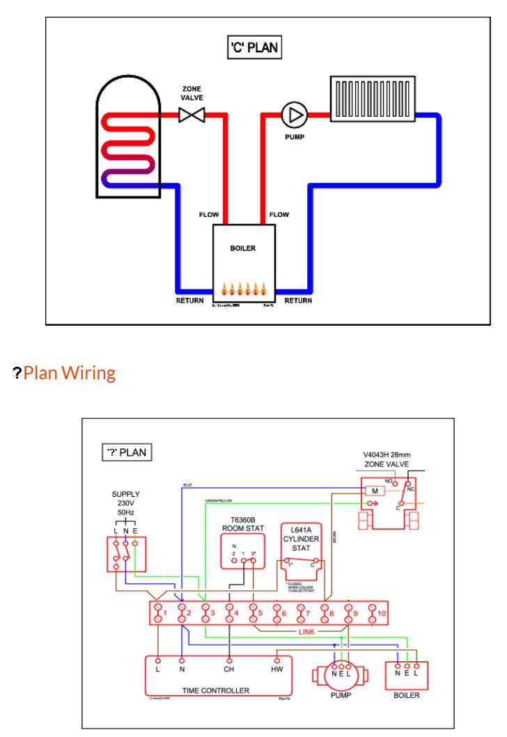

The question is, (assuming I can get to the 3 microswitch wires on the 2 port valve) can I just rewire this with standard c-plan sundial wiring, set the P-G jumper to P and have independent hot water and heating?
Electrically it looks to me as if the answer could be yes, but from a plumbing point of view my concern is the location of the 2 port valve, I've read conflicting opinions about where the valve should and shouldn't be but I've not managed to find a fully justified reason for any particular location.
Thanks for reading this far, any advice is greatly appreciated!

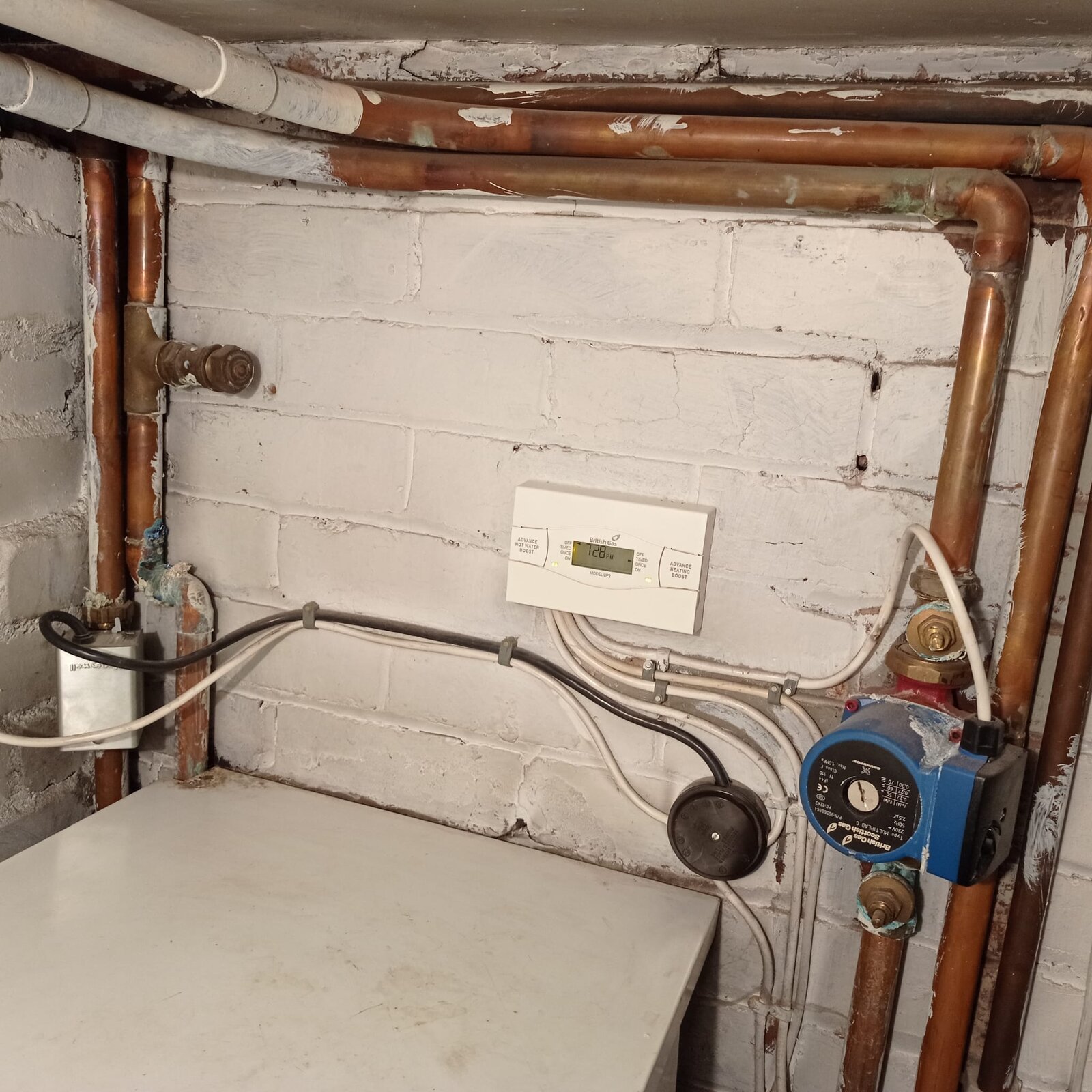

Sounds like the system may have been bypassed at some point? It may be feasible to just add another 2 port valve and renew existing/replace head. Can you post photos of the wiring center, 2 port valve, and possibly the programmer wiring?
The "wiring center" is just a round 4 terminal junction box with the common E L N and the connection between the cylinder stat and the 2 port valve.
I've attempted to sanitise things a bit and show what the existing wiring would look like if done in a standard 10-Way Junction Box...
Certainly looks doable from everything being close.
Yes, I thought plenty of scope for re-wiring too. But is the 2 port valve in the correct (safe?) place to allow for full c-plan wiring?
The Honeywell Plan C Installation docs state...
Valve - The zone valve should be fitted in the DHW primary circuit so that, when closed, it does not close off either the cold feed or vent. It is preferred that the valve is fitted in the return to the boiler.
But I have seen unclear/conflicting diagrams/advice and I've not managed to find a fully justified reason for any particular location for the valve being in the flow or return etc.
It looks like this valve is fitted just before the return into the boiler, but doesn't that effectively stop the cold feed to the boiler?
Sorry, I meant to advise, I would change it to an S plan.

C plan has changed over the years, first C-Plan_old2.jpg then C-Plan_old.jpg and thenC-Plan.jpg seems you have latter, since you can turn off the thermo syphon you can control DHW temperature summer and winter, and it can work either CH only or DHW only.
However it does depend on the house, I found even with CH pump turned off some radiators would thermo syphon, main problem is when CH is turns off but boiler remains on for DHW then since circulation started for CH it continued.
I have C Plan but basic first one shown, I do have motorised valves but to select with part of house is heated, or more to point not heated. I found although two pumps one for flat and one for main house, turn off one pump and the water flowed in reverse direction.
Plumber did point out if the TRV's close you should not get any flow, but flat TRV's were simple wax type and never seemed to be fully off.
He advised me not good for boiler fitting a motorised valve to DHW as no run on to cool boiler.
  • Thanks
Reactions: M51

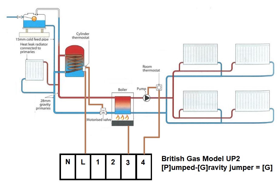

I realised that my diagrams didn't show the valve where it really is in my system, it's on the return just before the boiler, like this..
It sort of fits with the Honeywell Plan C Installation docs that state...
"Valve - The zone valve should be fitted in the DHW primary circuit so that, when closed, it does not close off either the cold feed or vent. It is preferred that the valve is fitted in the return to the boiler."
But I'm just not sure if the valve was installed in the wrong place and possibly that's why the wiring is very non-standard for c plan, of if it was wired like that due to lack of knowledge

So it is down to near enough engineering. I know there are faults, but it works reasonable well and I don't want to rip plaster board off the wall. This is my circuit diagram C_Plan_My_House-theroy.jpg as yet not fitted second relay, on my to do list, but don't really use flat so no real hurry. I found making the circuit diagram is important one to see errors, and two so some one else can work on it if required.

All rewired to the correct C-Plan scheme in a proper 10 terminal box and the Pumped/Gravity jumper on the controller set to Pumped.
Now have independent control over heating and hot water.
All working for the last 2 weeks without any issues and saving a fortune by not being forced to maintain a tank full of hot water when heating is on.
