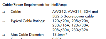

Jakarta make a load of datacentre monitoring hardware (humidity, temperature etc..) they are well respected, I've used their stuff, it's good and reliable.
I suspect therefore, that these would work rwell, I'd imagine they are designed to monitor current draw to server racks but without the necessity to power anything down. They'll probably also be reassuringly expensive (I reckon a couple of hundred quid each) for that reason I think the likelihood of them having multiple hall sensors and a bit of logic to do the calculations is probably how they work. Looks like an interesting product

I think the factor to consider in this context is the distance from the cores to any hall sensor versus the twist length in the cable. If it is small then the cores-in-a-plane approximation works better. So you might not get very good results with CAT5.
On the basis that it works, I'd surmise that the device is picking up the predominant flux 'leakage' from the conductor nearest to the actual sensor, ie that on the outside diameter of the cable. The only place where the flux truly cancels out, in a multicore bi-directional cable (flow and return), is probably the points at which both live and neutral surfaces are immediately adjacent or in contact, ie the central core of the cable. I note the literature suggests that the sensor position requires "optimising" "The intelliAmp’s unique optimisation system helps to ensure that the sensor is ideally positioned to obtain accurate readings"
