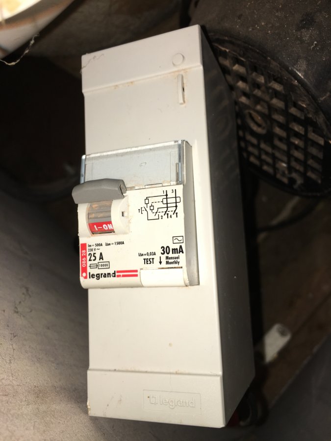

Stumbled across a jacuzzi/jetted bathtub that is currently connected through a 25A RCD unit as pictured. I have measured the power consumption of the pump and it is 500W with 0.75mm flex. They told me that the RCD unit came with the jacuzzi but I'm adamant that 25A would be too high for this to trip in the event of a fault and it should be a 3A FCU? Also we were going to install IP65 spotlights in the bath panel so I was going to install a new piece of twin and Earth to a 1 gang socket first as the bath panel cannot be removed without a screwdriver.

I'm afraid it may be worse than you think.
The 25A relates to the maximum current the RCD can carry; it is not an overload nor short circuit protection.
An RCD only protects against earth leakage and faults to earth.
There almost certainly should be 3A protection somewhere. Are you sure there isn't?
It could be a single circuit from the CU with a 6A MCB which may be alright unless the manufacturer states otherwise (3A).

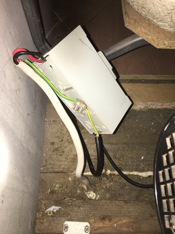

Also, the cable connection to the RCD is very poor.

Yes I have checked and the supply actually comes from a junction box on the kitchen ring so it is on a 32A MCB. The knockouts on the RCD unit haven't been used hence why the cores have just been squeezed in. o_O

How will the householder reset it if it trips? And is it suitable for installation in a bathroom?

If this is accessible are you able to put the RCD here instead of it's current place floating in the air being only supported by the cable terminating into it. Then put a maintenance free box somewhere suitable under the bath
Yes I did think of putting the RCD unit in the place of the junction box but this would mean it would be under the floorboards which I thought would make it more inaccessible than being able to unscrew the bath panel.
