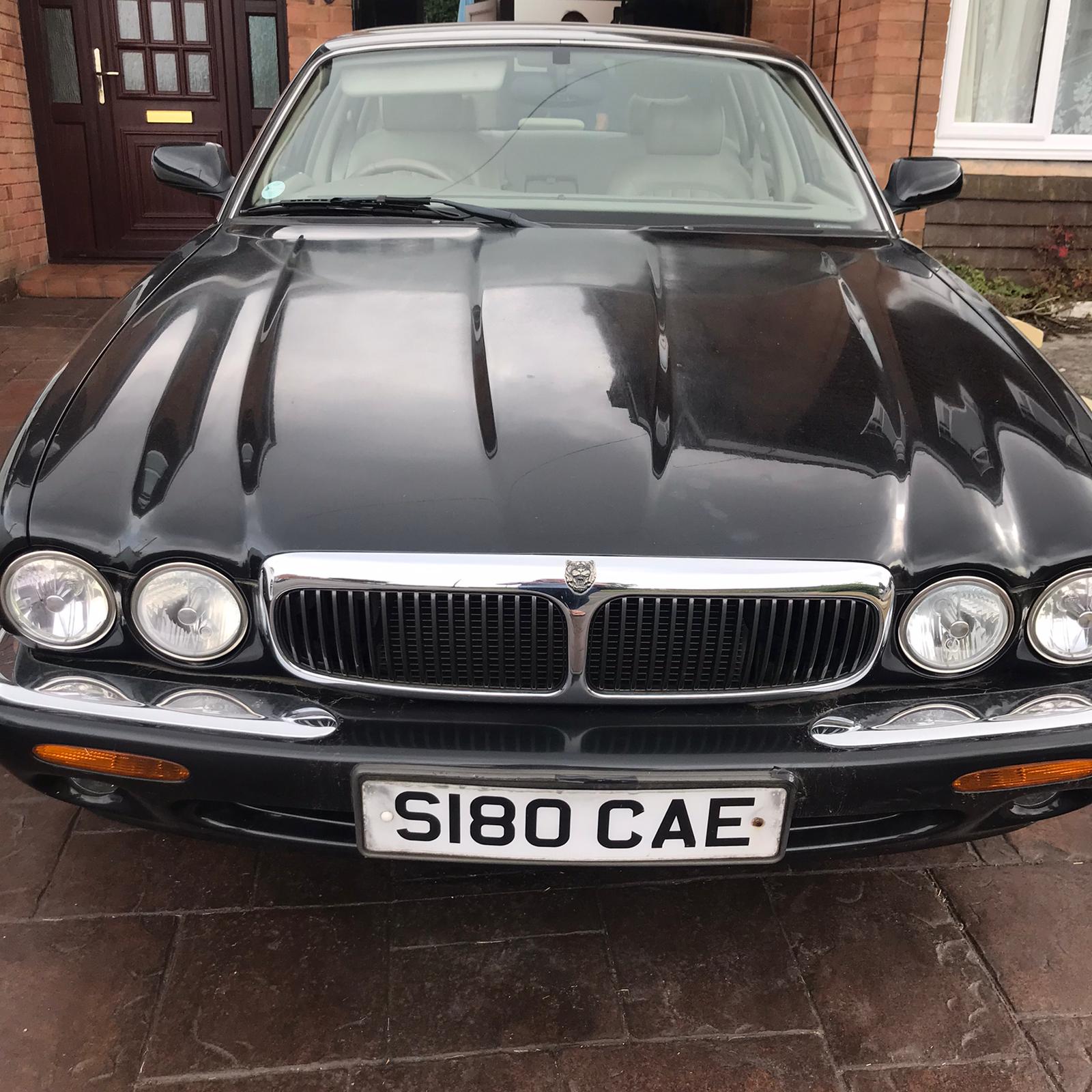

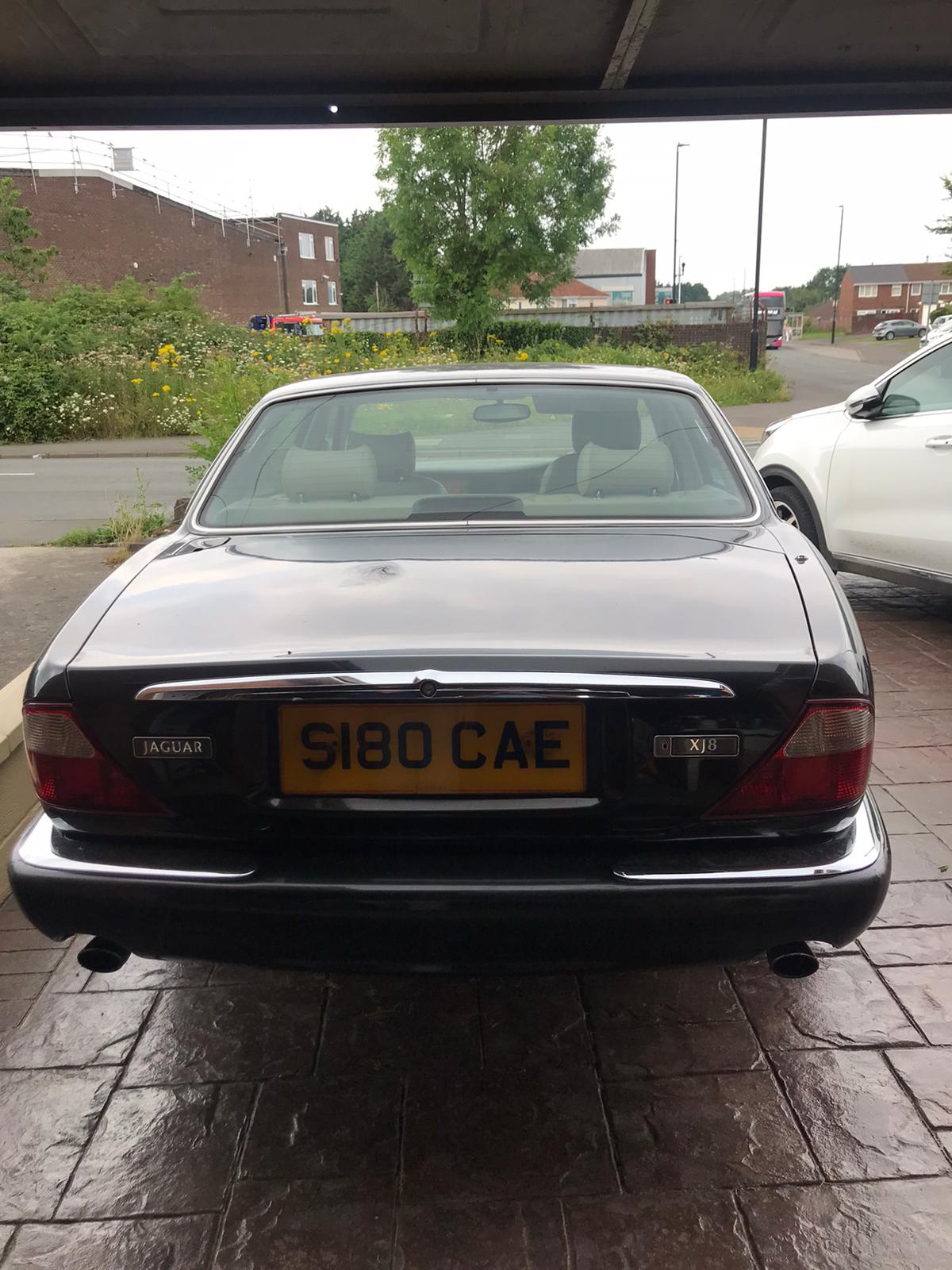

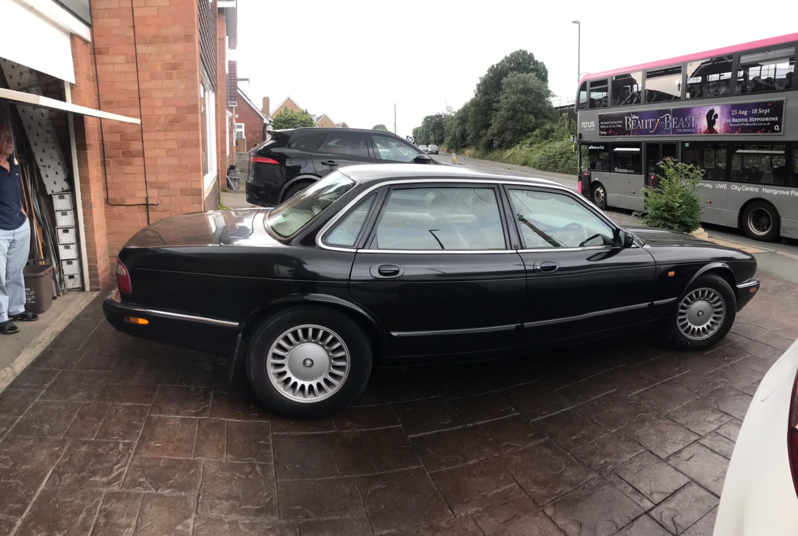

Thanks. Body doesn't look too bad, pics attached

nice and shiny, but you need to crawl underneath.
Very nice wheels, usually seen on the Daimler variant. I have an idea they are called "luxury"
rear passenger space on that model is a bit cramped, unless LWB. Test out all the luxury toys (there will be a lot) and look for instruction book and service history.
