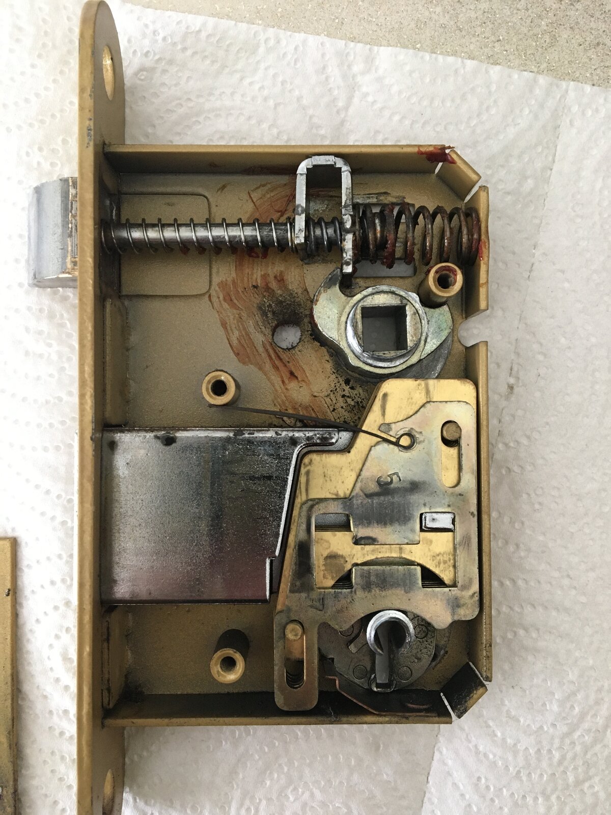

Good news!
Lubricating it seemed to ease it and sort it.
So all I really need to know now is what is the best lubricant for a mortice deadlock? Normal grease or graphite powder?
Existing internals have evidence of grease.
Presumably lube every interface bar where you would get it on your key?

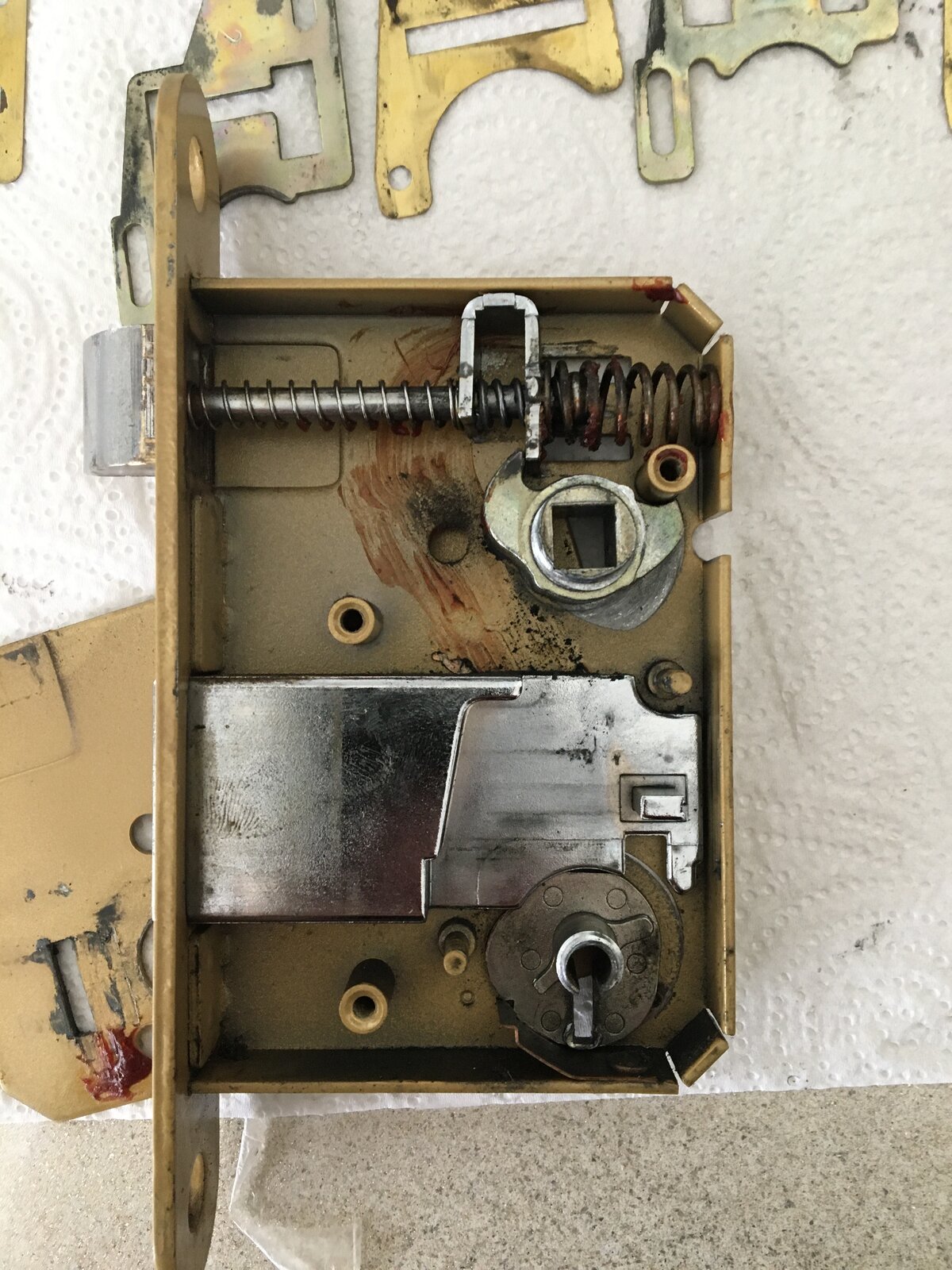

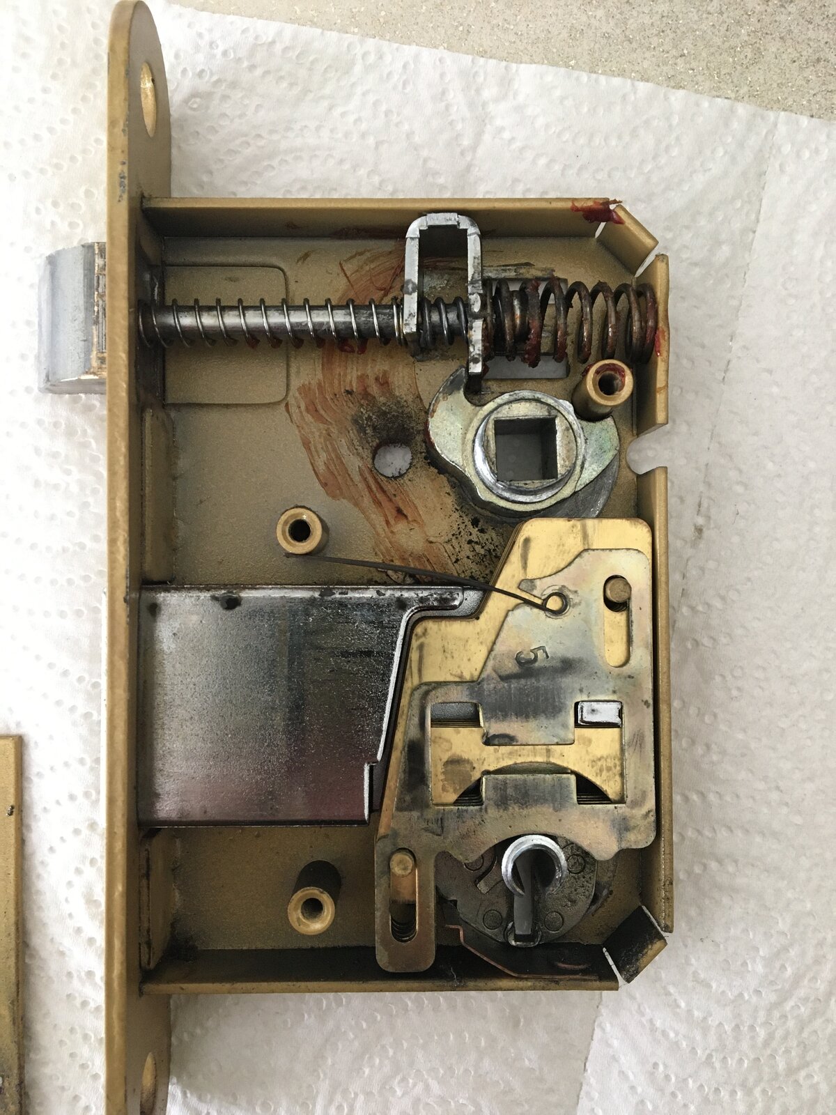

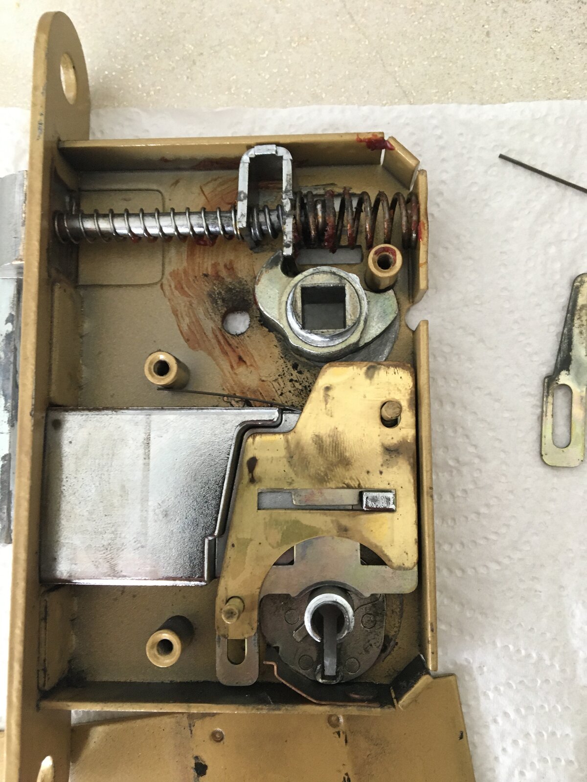

I see you've got it open now. Take that as a warning and either replace or thoroughly clean it. There may be a fault which will happen again. You should not use oil or grease as this sticks to dirt and grit. You can use graphite powder after you have cleaned and dried it. Put it between each of the levers, where they slide against each other, and the bolt, and each pivot or rubbing part (you will see rub-marks). Or you can use a "Dry PTFE" spray that is not oily or greasy.

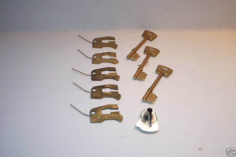

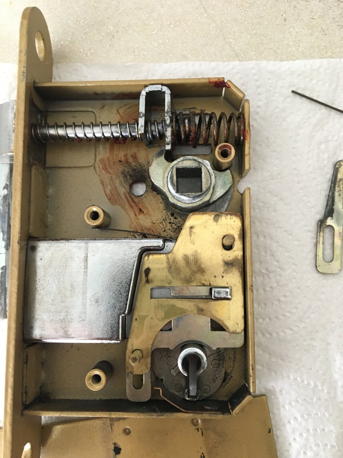

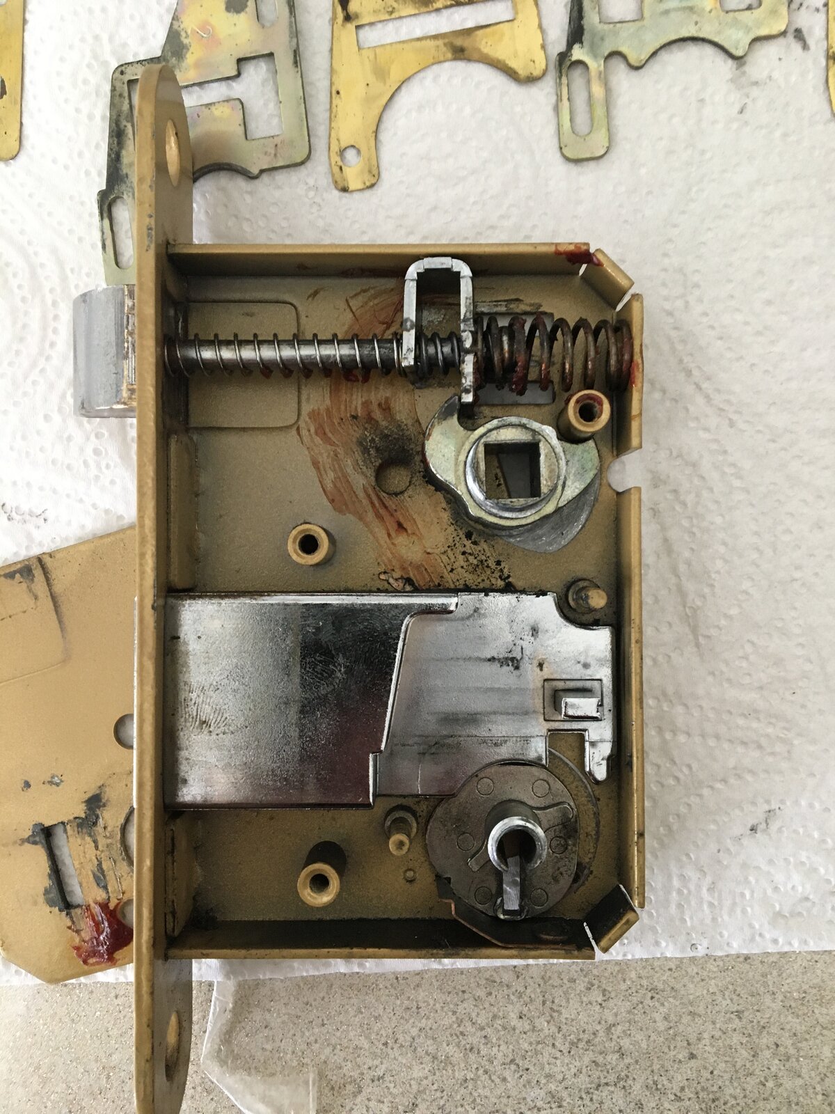

Take the lock case out, open it, photograph it at every step. Lift out the levers one at a time and scratch-mark each one "1, 2, 3, 4, 5" so you put them back the same way.
Clean every part in white spirit with a small paintbrush and set on kitchen roll to dry. Look for a loose screw or damaged part.
It might be that you have an open keyhole and dirt or grit is blowing in. In this case, buy a new keyhole cover for at least one side.
Look for the "year" in the Kitemark stamp on the front plate. What year is it?
A new British Standard 5-lever lock is cheaper than you think, and if you can get the same make and model, it will slide straight in.
If the door is warped, sagged or obstructed, it may be putting force on the bolt and preventing it from sliding. This is a carpentry job. You may need to move the staple ("keep") in the doorframe. Down, if the door has sagged, in or out if the door is warped.

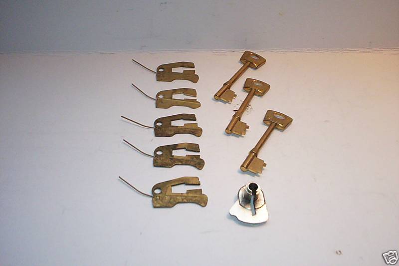

Here's some I did earlier
yours is likely to be simpler.

I stripped it and cleaned it with IPA so it was squeaky clean. I happened to have some graphite powder and the locks in my car were spinning a few months ago so I stripped and repaired those. They were fun to do...
I do indeed have an open keyhole. I'll try to get some keyhole covers. Presumably just drill and rivet?
It's not Assa. It's Asec. I've never heard of that brand. Anyway, it conforms to BS3621:2007 so it's more than a few years old as I see the BS was revised in 2017.
I noted that there are stamped numbers on the levers. Presumably I could tell a locksmith that I want a key made to a certain number and switch the levers around. The key is symmetrical which I think is less secure than if it was asymmetrical perhaps? Would you agree?
I should perhaps adjust the keep. Just didn't want the door rattling in Autumn/Winter/Spring when it's cooler. I did actually think of getting a coarse file on the keep rather trying to adjust its position.
I couldn't see any obvious signs of wear. It appeared to have a mix of either grease and graphite or a molybdenum grease inside.

I'm pretty confident it is not overtly worn out but I do think the bolt hitting the keep and me having to put weight against the door to lock it is probably somehow accelerating wear. There is a slight dink in my key now where I tried to force it.
It's possible the old grease had hardened and prevented levers moving freely, but I suspect the warped door jammed the bolt.
Also, keys wear over time, so might not lift the levers enough from one side. The other side of the key may be less worn.

The numbers on the levers indicate what lift that lever has
The keys to 5-lever locks are always symmetrical so they work from both sides of the door
