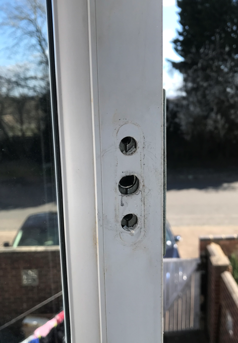

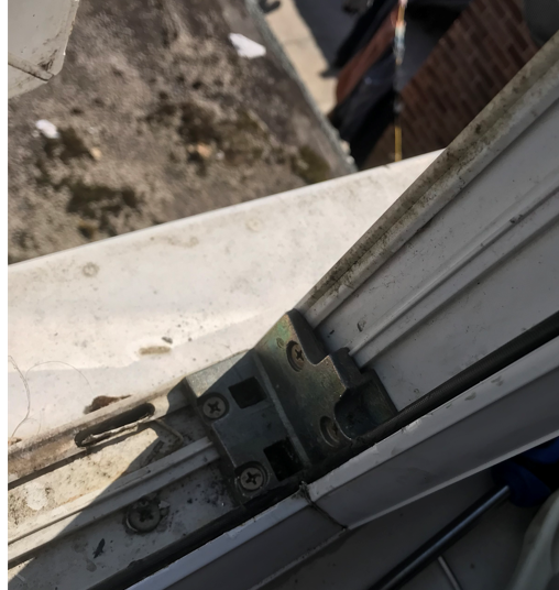

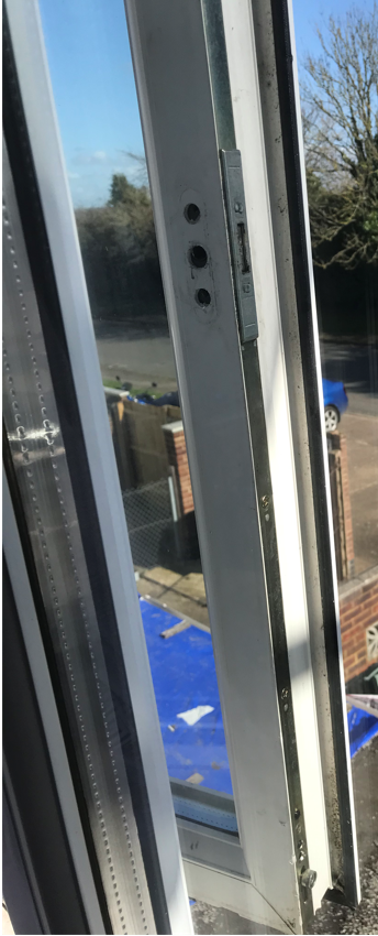

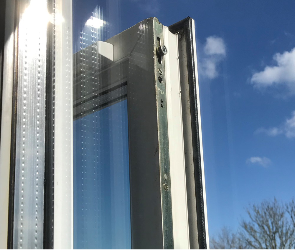

UPDATE: opened up the window using the technique described in the video. The issue is being caused by one of the shoot bolts malfunctioning. When you lock the handle (closed position) both shoot bolts push out as expected but when you open the handle, only one shoot bolt returns to its position. The other shoot bolt is still protruding. If I manually push the mushroom up for the offending shoot bolt, it returns to its closed position. Clearly this can’t be simulated when the window is closed during normal use. This is causing the window to jam.
Have sprayed it with WD40 but to no avail.I would welcome any suggestions.
Thanks in advance.
I would appreciate any advice on the above situation please.
Here are some pics:
Hope that helps. Also, can the replacement espag be one that only uses the mushrooms and doesn't have the shootbolt? presumably, the length of the espag can also vary in that case, as I can move the catch to suit. I was thinking that the local hardware shop may not have an exact match.
