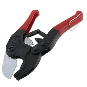

jg speed fit/copper?
Yes, preferably cut the copper with pipe cutters to give a smooth edge.
Preferrbly this:
or this:
but definitely not this:
I've had people return them because "these pipe cutters don't work on copper".
