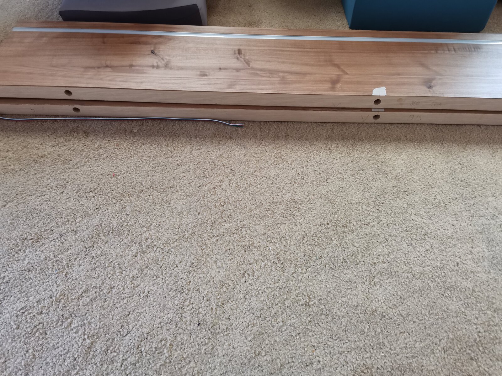

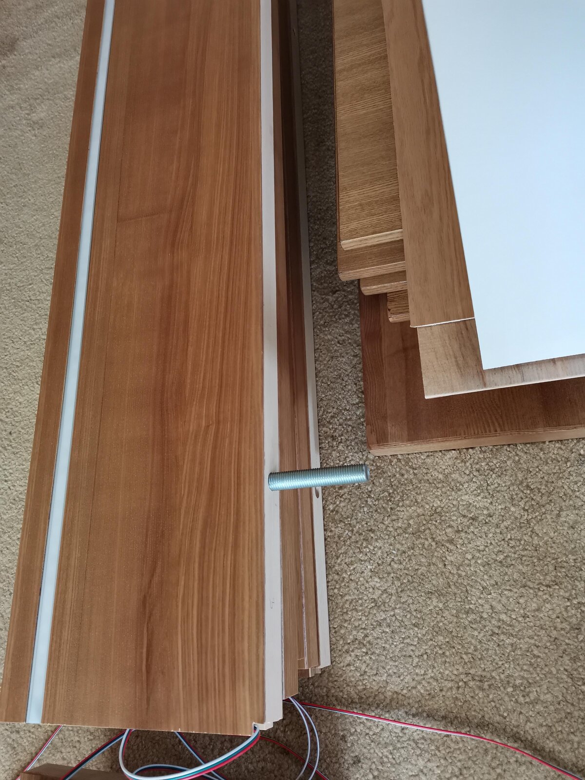

I've got some custom made floating shelves from overseas that are supposed to be hang on M16 threaded rods on the brick wall, and they came with predrilled 16mm wide and 85mm deep holes (to screw in the threaded rod). However while I was measuring things up, I forgot to check for cables, and of course on couple of places the hole would hit a cable.
So the easiest option is just to re-drill the problematic holes in the shelves in different place, rather then moving the cables in the wall. But I'm not brave enough to try to do it with home equipment, and also joineries I had called are not confident they would be able to do it. As far as I know, original holes were done on dowel boring machine. So I was wondering if anyone might know any trade that could help me? I'm based in Warwickshire, but at this point I'm willing to travel some distance, as anything is better then redoing the cabling in the wall.

Before you embark on any long journeys, check what the structure of the shelves is.
They are clearly not solid wood.
img_20210426_084957-jpg.235063
Do they weigh what you would expect solid ones, even solid chipboard, to weigh?
If you tap them, do they sound solid or hollow? Do they sound the same all the way along?
Im not trying to be alarmist, but I have seen floating shelves where internally they were hollow, but there were frame members running front to back where the holes were.
If yours are like that then you wont be able to have holes in different places..... :(

Thanks, however they are pretty heavy, veneered mdf. The reason it was done overseas is that my family lives there and offered a help from a joiner they do business with, and I couldn't say no and the re-drill approach is approved by him.

I'm supposed to be fixing it with a chemical resin. Already making the holes in the wall bigger to allow for sloppy drilling accuracy, but wanted to avoid that in the shelf as now the threaded rods nicely fit and stay in place.

If you have contact information with the joiner, ask them what the structure is.
As said, often a box frame is made, and a piece of timber is added just where the bolts are intended to go.
Then it's covered.

"drum" across it with a wooden or round plastic handle and listen you will hear a very clear difference iff its hollow between the holes less so iff there is any odd eggbox or ply /thin wood walls in the void??
