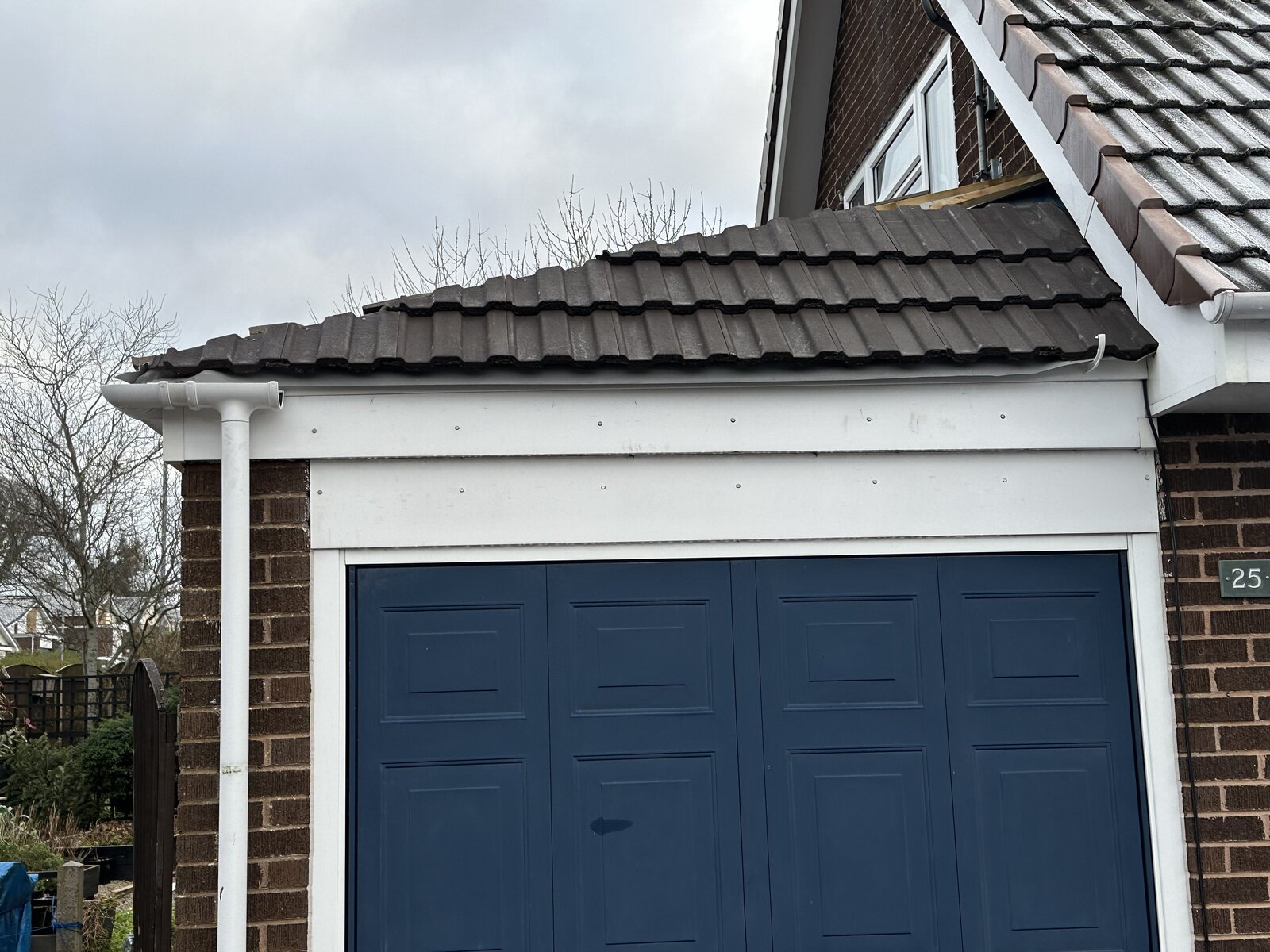

Joining 2 gutters of different heights to down pipe
23 Jan 2003
241
Hi some advice please

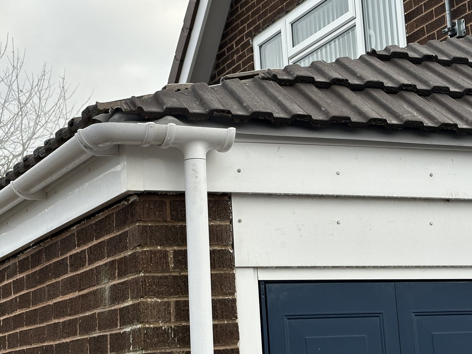

You will see from photos I need to allow the front gutter and side gutter to meet the down pipe.
1: The front gutter must be higher to avoid a big gap and the felt be visible
2: The gutter coming from the side can’t be any higher due to needing the fall
3: I don’t want to simply put two outlets with stop ends (one on top of the other) I want something “tidier” as it’s the front of the house
Any ideas folks?? Thanks
That front gutter is far too high imo. What bout cutting the gutter slightly longer than needed and offer it up and see if the bracket can be lowered?
That right hand bracket is way too high I doubt you will even get the guttering in that before its back edge hits the underside of the tile. Fit the bracket lower and the gutter should then run to the outlet easily.
I agree but ideally I don’t want the membrane to be visible
