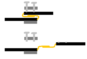

I have a new set of 'very low voltage' fairy lights that Ive cut through the cable wire by accident. I cant work out what AMP connector block to get . There are 3 very thin wires. On the transformer plug info is INput 200 - 240 v ~ 50hz 0.30A output 30v - .24A max 7.2 VA. On the label on the wire it has Voltage 30 v wattage 7.2 w . Ive got 3 x 5amp connectors. Will these be ok or do I need to get higher rated ones. Normal plug yo could just look at the fuse and know where you are up to . This is very confusing. Any help gratefully received. ( any decimal points that should be in the figures above and are not is because the writing is so tiny - these are just standard Christmas lights x 240)
Get the smallest connector block that will admit two of these "very thin wires" wires side by side. Strip the wires to the length of the metal block inside the connector, then put one wire through from one side and the other through from the other, then wind both screws down on both wires. Bear in mind, particularly for fine stranded wire, that doing the screws up too tight will cut the wire; be gentle. If your blocks are too big for the wires (the wires pull out even after you've tightened the screw down) and you can't get a smaller one you can strip more and loop the wire back on itself, possibly a few times. In the past I've also had to resort to wrapping the stripped end around the wire sheath and tightening the screw down on that instead

0.24 A maximum current so 5 Amp connectors will be more than adequate in terms of current.
Ensuring the very small wires are physically secured in a standard terminal block may be a problem. Packing out the entry to the terminal block with aluminium foil will spread the pressure onto a small wire that might otherwise move away from the end of the screw.

another method I've used with choc bloc is to pass one wire right through, twist the wires together leaving enough copper exposed to get through the connector then overlap the insulation and clamp both sides with both screws
It's quite fiddly but the tension/wear is taken on the insulation instead of the fine copper.
