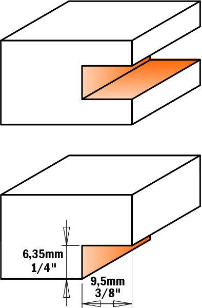

Yes, exactly this! And a biscuit joint sounds great but how do I do that easily whilst the floor is on the floor? I started to take a chisel to it to try and make a groove to accept the tongue of the new floor and it was nye on impossible.

It depends on the thickness of the flooring. A biscuit slot is 4mm high and is normally centred in a board of 18mm (or thicker). Registration, however, is best done off the top surface by dint of a swing fence. A problem in tight spaces may be the length of the tool, though
An alternative would be to use a router with a 4mm slotting cutter mounted on an arbor with the depth control bearing mounted above the cutter and the cutter shimmed to sit right at the bottom of the arbor to minimise bottom projection. A fairly standard piece of tooling. I think you'd may be be able to accommodate down to 12 to 14mm thick material this way. I know first hand you can do 18mm thick in situ by positioning the cutter right, having recently used this technique on solid oak flooring
To go below 12mm on an already installed floor you'd need a bottom cleaning slot cutter (or T-slot cutter) such as the Trend 35/10, but with a fence arrangement to suit. I'm sure there are similar cutters out there with a top bearing, but having never needed one I can only speculate. Maybe a trawl of firms specialising in solid wood flooring supplies might turn something up? I am, however, certain that the biscuit slot cutter in a router (actually even a pretty gutless cordless trim router with a plunge base) does work providing the floor is thick enough
Bear in mind that to get clearance it might be necessary to lose a row of existing flooring should it be necessary to gain additional space to accommodate a router, even if it is a small one
Edit: Found the type of undercut cutter I was referring to:
This particular one is a CMT 823, but Trend sell a similar product in both their Professional and CraftPro ranges. They are designed to cut a 1/4in (6.35mm) slot for standard flooring tongues (or 1/4in plywood). Amazon do a cheaper Chinese version by Yonica for one -off jobs
