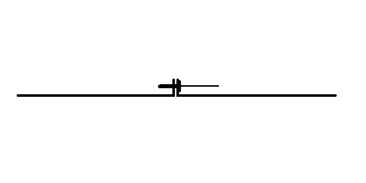

If I understand what you're after, it's something that can only really be done neatly with the right tools. The edges of the sheet should be hemmed to remove the raw edge. It's basically a return in the sheet 180deg.
To join two sheets without one being proud of the other, use of a joining plate or fixings, a double hem lock would have done it.
Edit: See:
The only way you're going to join two pieces and keep the one surface flush with the other rather than having one proud, even if it is only 1mm, is by forming a return on the end of each piece and fixing it there; but from what it sounds like, that won't be satisfactory either.
A drawing, no matter how rudimentary will help explain your thinking.

Ok so I have a flat sheet of metal where from the bottom I am looking at pop riveting to another piece of metal and bending this up and then maybe using some form of joining plate for the corners. This would make like a tray for the bedding so only a thin layer can be places so around 50mm high (roughly). I am looking at trying to keep this as flush with the cage as possible as the cage has two levels and bars so the animals don't catch it when downstairs but also when I remove the tray I don't catch it.
Something similar to this I am trying to achieve:
http://www.johnhopewell.co.uk/content/userfiles/IMG_2654 steel trays for explorer cage.JPG
I have asked the guy who does these but he cant make them in the sizes I need them which is why I am trying to improvise with what I have got.
I hope this clears up some confusion (well the picture anyway).
James
Something like that is going to be made using proper sheet metal brakes and seam formers. You could do something similar with a flat sheet, decent forming hammer, vice and some pieces of timber but it won't be as neat.
