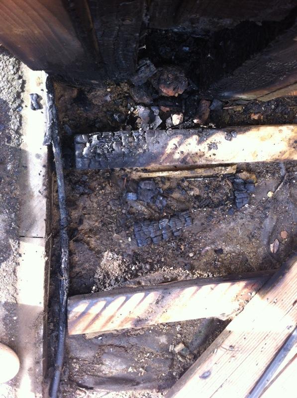

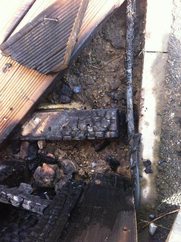

I had 10m of 10mm SWA installed last year, into the garden by a sparky. This afternoon, there was a small fire (caused by a cigatette!!) that had burned the outer sheath of the SWA. About 2 feet in the middle. There is enough SWA to cut the damaged part out move it along (there is about 3-4 feet of excess) and resin join them together. I am capable of doing this, but an I allowed to?

Obviously its not buried so wouldnt it be cheaper and easier to renew the cable and do it properly , youd get some scrap value for the old cable as well
Epoxy shrink sleeve may repair without need to cut. There is some with like a zip so you can fit without sliding it along from one end.
Depending on how bad Self Amalgamating Tape and then standard insulation tape over the top may be good enough.
As already said pictures would help.
With that amount of heat the cable needs an ir test, how would you know the state of the inner core sheaths.
They may well have melted and you could have direct contacts between the LN and E.
Cutting out and jointing in a bit isn't viable.

strip the outer sheath and see what condition the serving under the SWA is in, if that is melted you'll have to inspect the cores underneath and as suggested a 500V megger test would be needed.
If you there is no damage found you could re connect the SWA and encase the whole lot in a wooden trough and then fill with jointing resin (if you can get it separately), or as you suggested cut a piece out & rejoint it.
Thats what I think I will do. I think some of the 2 core sheath has indeed melted, hopefully only only in the 2 foot where the outer has melted though, which will be cut out.
I don't see any reason why the damaged part can't be chopped out and joint a new piece in with 2 resin kits.
