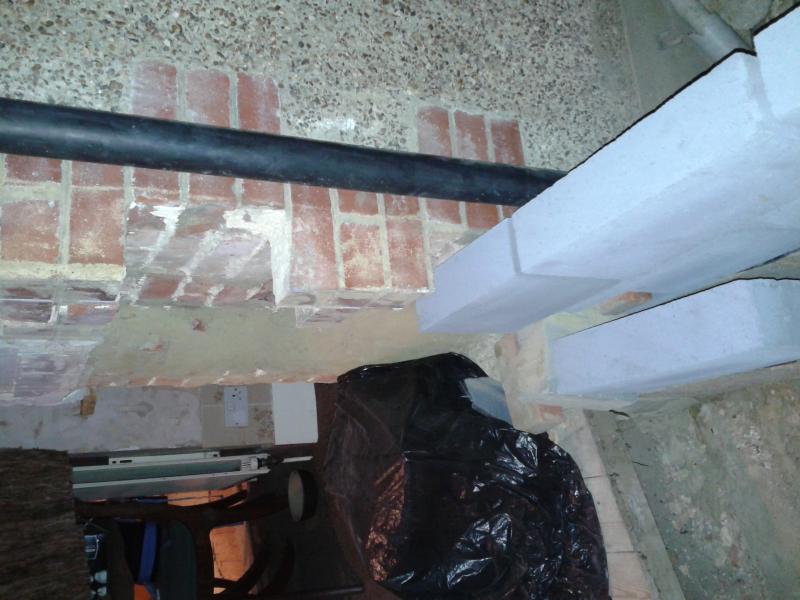

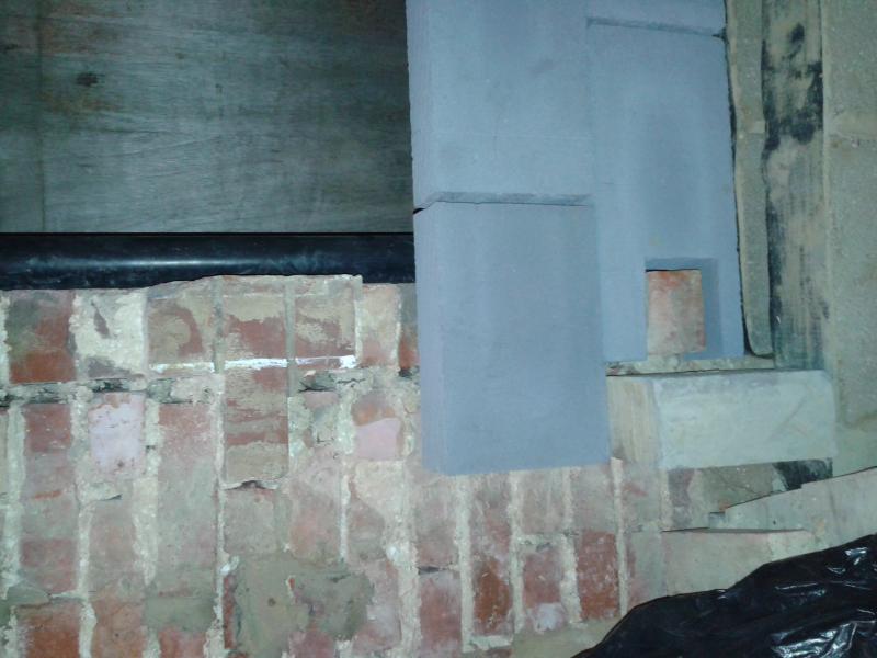

Hello.
Is a wall starter the best option for this?
I've knocked down the strange angled (think parallelogram) side wall on my kitchen extension(brick/block) and I'm replacing it with a (square) thermalite wall.
At one end a wall starter seems the only option but at the other end I think I could cut the blocks to tooth in to my 9inch original solid wall.
Didn't ask the BCO when he was here as it was going to be done by a bricklayer.
Let down by 2 brickies this week (one genuinely injured..the other....?).
I may start doing it myself (10ft x 10ft). Dense concrete block up to damp course already done.
I've posted some pics in my album(head 90 degrees left for second and third pics ). The thermalite is just sitting there dry as I attempt to work it out.
Your advice would be appreciated by this novice in the bricklaying world.

There are some red flags in your pics. I'm surprised that BCO has allowed work to proceed.
I dont enjoy saying this because i'm all for DIY'ers cracking on (the blockwork is well laid indeed) - but you really need a builder on site, for at least a paid view, and a bit of advice.
Thanks Dann, it's all being done under BCO supervision. Basically, the edge of the floorboards marks the original wall( :eek: ) and the blockwork is the new position.
The pebbldashed corner nearest in the first pic has a wall starter on it.
My biggest concern is joining the blocks to the red brickwork at the squared off end.
As you can see there are 3 brick course gaps (only 2 line up) and I wondered if I could shape the blocks to tooth(?) in with those. If that's against regs, I could attach a wall plate to that end as well.
To this layman, wall ties don't seem that strong.
Thanks for replying. :)

LATEST: Got through to BCO officer...OK to bond the brick and block. No problem to shape the blocks. Wall starter the other end.

Probably being picky but the lack of brick showing below dpc and the cavity looks a bit narrow.
Not sure how you can see that there but you're right...the patio is a bit higher than it should be. It's next on the list so I'll take it down when I redo it.
Cavity 75mm requested by BCO between lightweight blocks (100mm for anything else).
Was gonna use heavier blocks on the outside but 'Superbrickie' (the one who went awol) said he'd do it in a day with the light weights. :rolleyes:
Trowlerman.... there was an airbrick but only in the outside leaf for some reason. That's not right is it?
Airbricks at the back and further down the side. I'll have to sort it if it's unacceptable.
