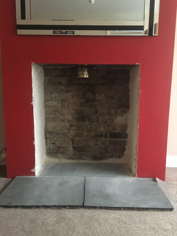

I know this is an in the garden forum but this is the hearth in my living room. I put it here as it's still essentially paving slabs & the joints on them so figured it may be the best spot to ask this?
Basically our living room suffers terrible damp. Those that installed the fire installed these black limestone paving slabs and from what i remember they put bonding in the mix which popped the front right flag up.
They came out, re-did it with a sand and cement mix, no bonding this time. They also laid down a DPM. I can't remember whether it was wide DPC or whether it was visqueen. I've a funny feeling it was a fairly wide DPC. Obviously this was to stop the damp getting through since ours is quite bad.
Now we've needed the fire out because of a separate ongoing issue but you can see there the joints have gone.
Is there a way to stop that happening again or due to it being damp underneath, even with DPC strips there, and then the heat from the fire, it's just going to happen again & again & there's nothing you can do about it?

1 big slab is something i've been thinking of. It would surely be have to cut to size though but it's something i've thought of. Not sure of material though. We went for black Indian limestone as we liked the look of it.

A full size slab would probably crack with the heat of the fire (esp if you use coal). That is why hearths are usually laid in two or three pieces, (our marble hearth is a 4 piece)
As for the pointing coming loose - have they used a proper 'fire cement putty' ? if they skimped and just used regular cement then that fails pretty quickly.

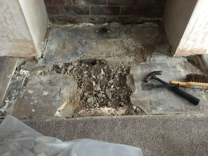

That's exactly what's going down. The paving slabs have been taken out.

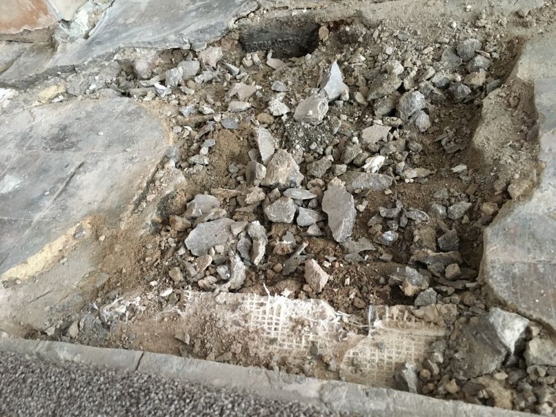

I knocked out the old cracked cement and it had this layer of sand like stuff underneath in the middle.
Regards fire cement putty, i don't think so. I'm pretty sure they sat it on a bed of sand & cement. I didn't think you'd sit paving on putty? I thought that was for things like around your windows? It's all over my head anyway.
