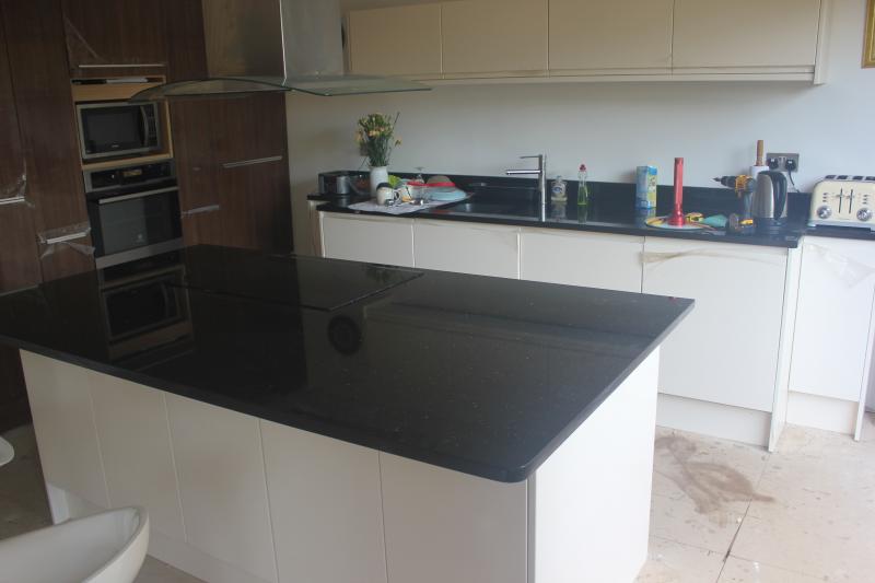

The kitchen is downstairs and has a large granite island with more granite by the sink.

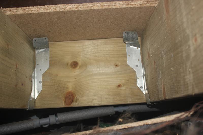

Are only a few nails required like shown; see the below pics for the joist hangers.

the reason they have all the holes in them is so everyone has a nail in it.
only a couple each side then i would say something will fail over time.
I have just repaired a floor using some simpson joist hangers and it states on the hanger itself what nails to use and how many in which part for top wrap or not top wrap.
My joists ar 3"x7" and I think it is (for top wrap) 4 nails into the joist, 8 nail into the face and 4 nails into the top wrap using 30mm x 3.5 square twist nails.
If the picturs are of your joists, there would appear to be too few nails in for a start.

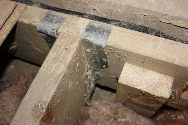

Yea, the pictures are my joists in the kitchen; don't know the size of the joists of by heart. They have 1 nail in the top, 2/3 in the side and faces each.

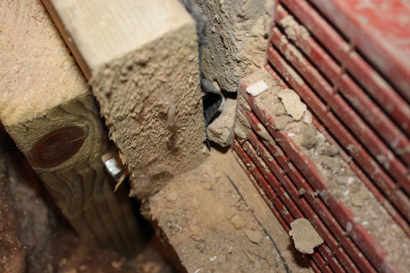

Also the last picture is where the securing bolt into the block has cracked part of the end and has come out of the block at the end.

As above, it's probably your island (in the middle of the floor?) being too heavy for the joists.
Although published tables give load/span relationships for domestic floors, unusually heavy permanent loads need special consideration.

The joist hangers have on averarge 12 out of 27 possiable nails holes used, with the worst case scenario with only a 10 out of 27 holes used.

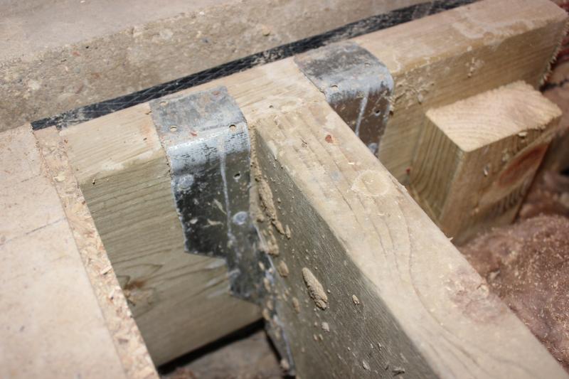

What is worse and shocking are the photos below, where the joist hangers are not bent over the top and only have 5 nails in per side. Quite a few are like this!

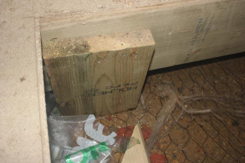

(This is where the side of the kitchen (towards the oven) that dropped originally, see second the picture of the reinforcement below that has been put in place since the original drop.)
Finally I have attached a picture of the granite worktops to give reference to the size of them. The main island is 47 1/2 x 85 inches, the kitchen side is 97 x 24 inches.

Just why do the joist hangers have all those wholes if they are not needed?
Because whoever makes them says so to protect against any claims. They work it out on the chances of a nail shearing vertically, so more nails prevents shearing potential
Joists work in a load sharing way, so not all the load from the floor goes onto one end of any given joist, so a few nails in a few joists will not mean that the floor will collapse
There is some inherent movement in these hangers and it is often recommended to fit solid blocking (ie noggins) near to the hangers at the end of the joists.
Yes strictly, there should be a fixing in every hole, and the hanger strapped over the top of the timber it is fixed to. But I can't see that solving the floor bounce problem
