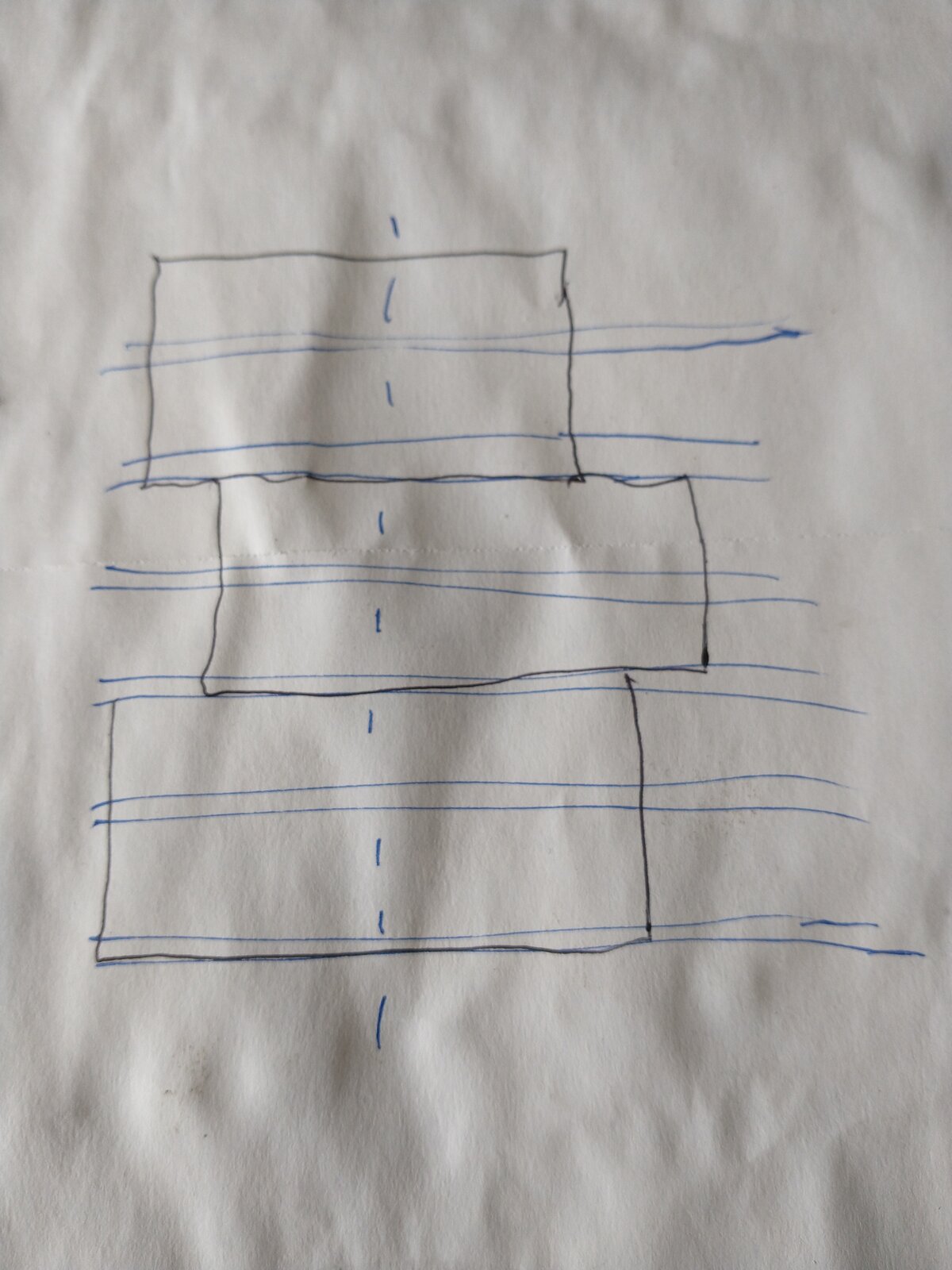

To avoid ceiling cracking don't put any board joints near the center line:
