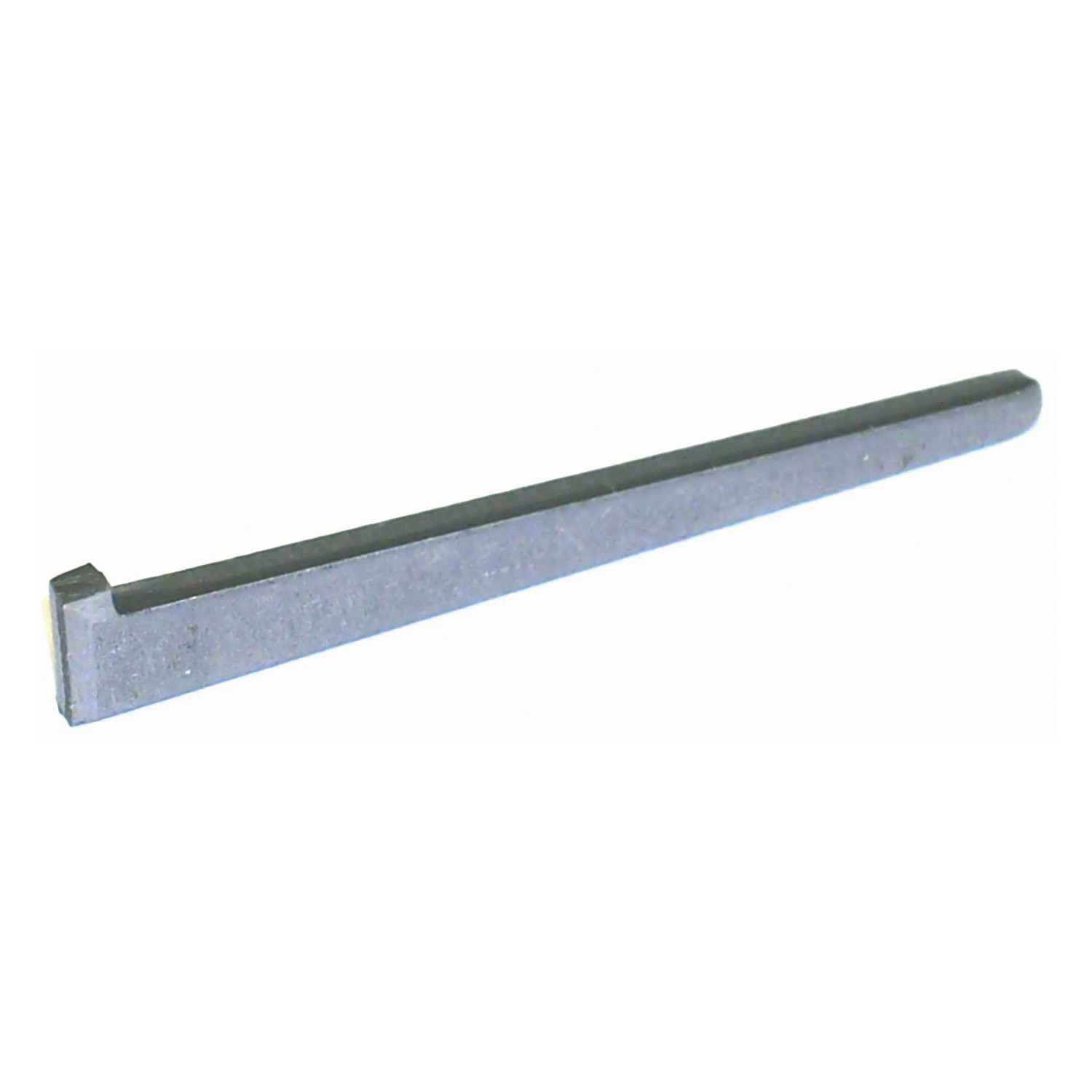

Another question: I've not encountered previously the type of nails used to secure the floorboards. Anyone know what they're called?
Should I be concerned about the splits along the top of the joists as I'm pulling up the boards and nails?

That nail is a brad (As I know them)
No idea what's "standard" for 100 yrs ago, I think it was more a "that'll do" attitude
Just goes to show local differences; I was brought up to call them "cut nails" (because they are cut or punched out from a ribbon of rolled steel). They are still in use, at least in my part of the world, because they are less likely to split softwood floorboards than either "French" (round wire) nails or oval nails. To me a brad means a smaller nail these days

They were difficult for the joiners to use as they could result in cut fingers due to the sharp edges - gloves were adviseable. They were less liable to split the wood as they tended to chisel through the grain, rather than force it apart as wire nails can do.
Today they are frequently used to nail skirting boards to lightweight concrete block (eg Celcon, Thermalite etc) as they have far greater holding power than the smooth finish of round wire nails or ovals.
Not so much "were", Tony, as "are" - we still use them for some flooring (albeit not a lot). Certainly on bigger sites gloves are mandatory these days, and have been for maybe 10 years(?), so anyone with half a brain in their head it shouldn't tax them too much to understand why one need to wear gloves whilst handling timber and metal

I've pulled out about a million of those. I screw the boards back down again with those posi something star or hex head screws
