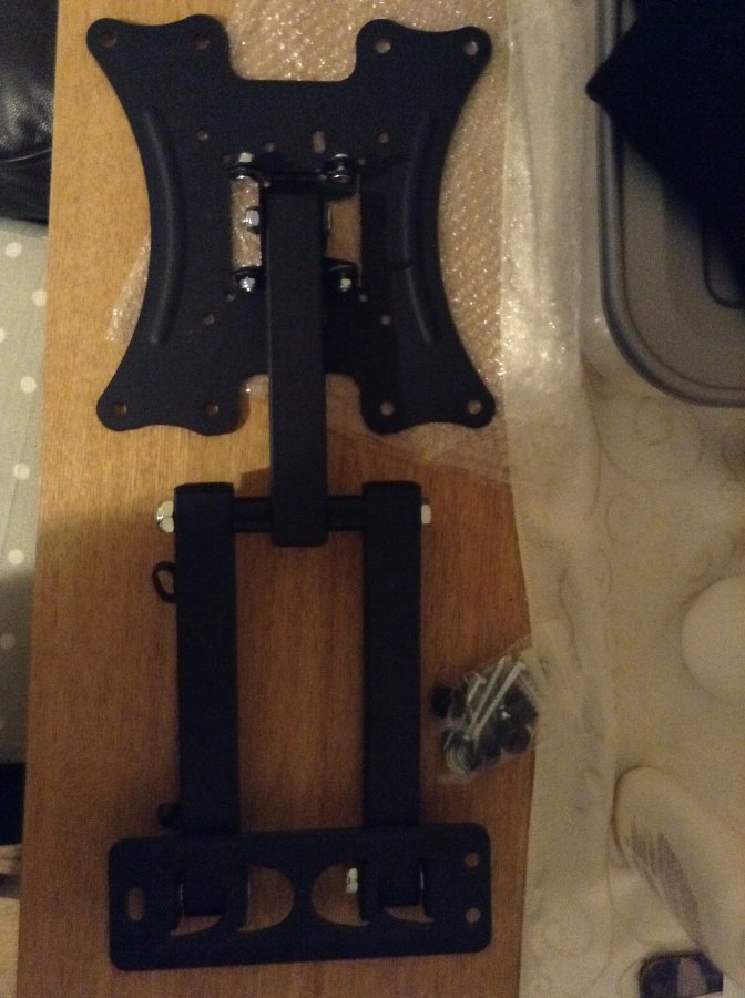

If your TV wasn't on a cantilever bracket i.e. it was on a flat wall bracket instead - then the answer would be yes. But as soon as you have a bracket that moves the weight of the TV away from the wall such as a cantilever bracket, which is what you've got, then you start to introduce a lot of leverage. This multiplies up the effect of the weight so it's the equivalent of hanging a much heavier TV. If you've ever tried to open a tin of paint then you'll know that it's virtually impossible to prise off the lid with your finger nails, but much easier if you use a screwdriver with a long shaft. That's the effect of leverage. In situations like this you really want to get a solid fixing on to a stud.

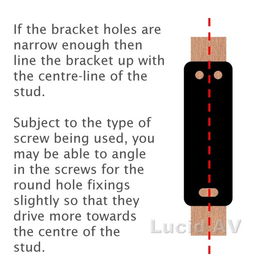

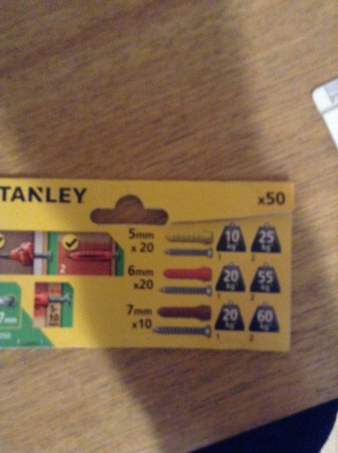

Fixing your bracket: If possible, align the bracket with the centre-line of the stud. If not then at least try to get two sold fixings - one each for the top and bottom holes. It would be better to use larger screws than come with the standard fixing pack unless those ones are particularly large. There are two reasons for this: First, a screw with a larger surface area provides better grip. Second, many of the screws supplied with brackets are made of a softer metal than those you'll buy from a DIY store. This means when fixing in to something firm the soft metal heads get chewed up by the screwdriver. After that then it's much harder to get then tightened up properly and they may even be impossible to remove to fit something better. It's simpler to use better screws from the outset.
