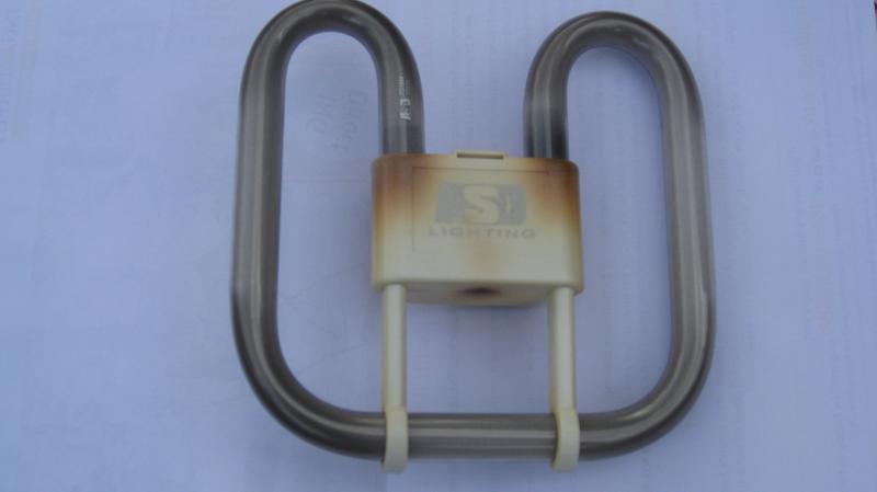

if you replace that 827 four pin, 28watt , warm white lamp with a 835 four pin,28 watt, white lamp it will be brighter
This is how hot one of them lamps got once before it died, it was a 16watt, smaller than the one you have.
It is rare to get this bad , but they do run hot
I've never seen the glass go black all the way round :eek:
Quite common to find the plastic bit has melted in commercial environments.

Impressive eyesight, you can read the number on the bulb in that pic :eek:
