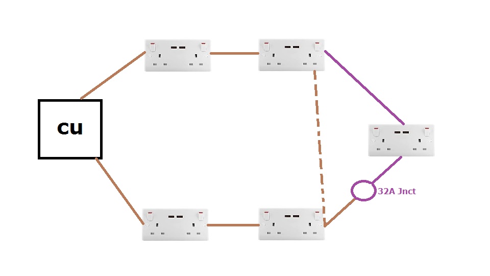

As per some previous posts, I have a ring main extension ready to cut in once I can get the spark booked to fit me a new consumer unit.
In the meantime I have just one socket downstairs to add so am looking to cut that in before that. I can't spur it as I intend to spur off this new socket at a later date so it needs to be in the ring main itself.
I have a 32A junction box and can I cut it in like in the diagram? (the brown lines are the exisitng wires, the purple is the new. the dotted brown line is the bit that will be removed). Is this absolutely how to do this or do I need a junction box on both sides?
The reason I am getting unsure is the more I read about maintenance free and Wago; the junction box will go under a floorboard but will be easy accessible, it will be cut and just screwed back down but some say that Wago boxes are absolutely needed and you need two of them?
You could if you use 4mm² T&E.
You don't need a junction box if removing the existing cable between the existing sockets.
They must be in an enclosure anyway.

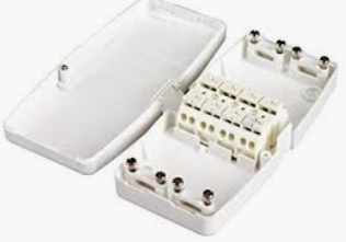

An alternative:
https://www.tlc-direct.co.uk/Products/ASJ803.html

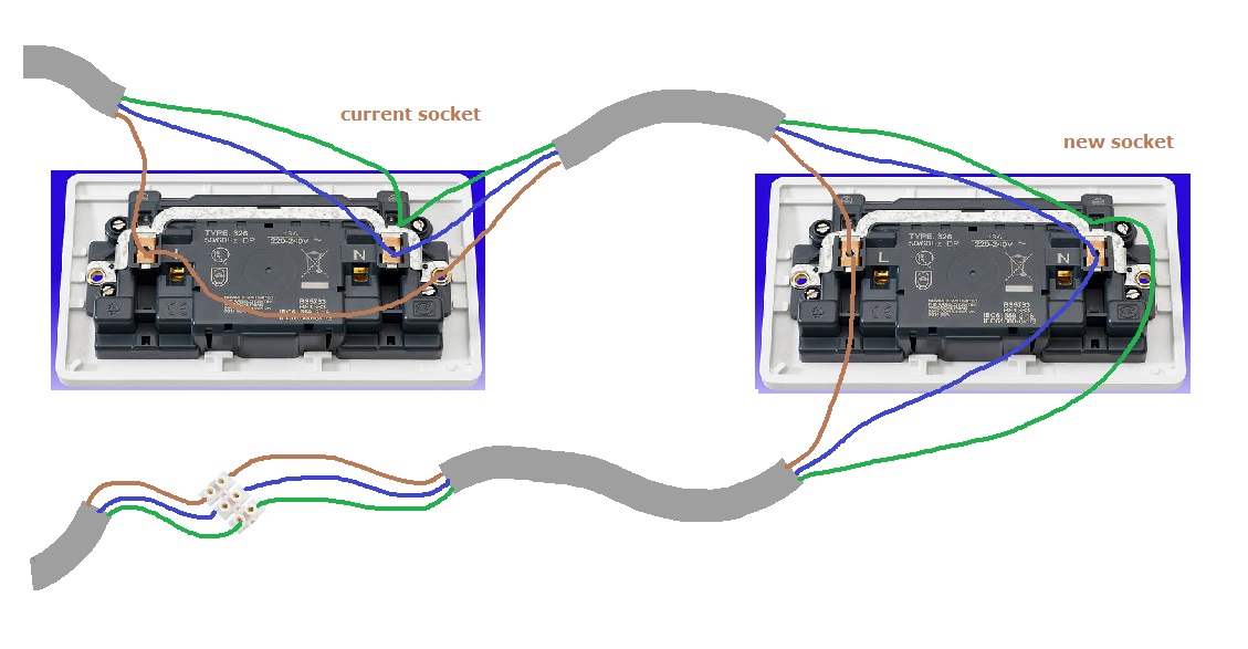

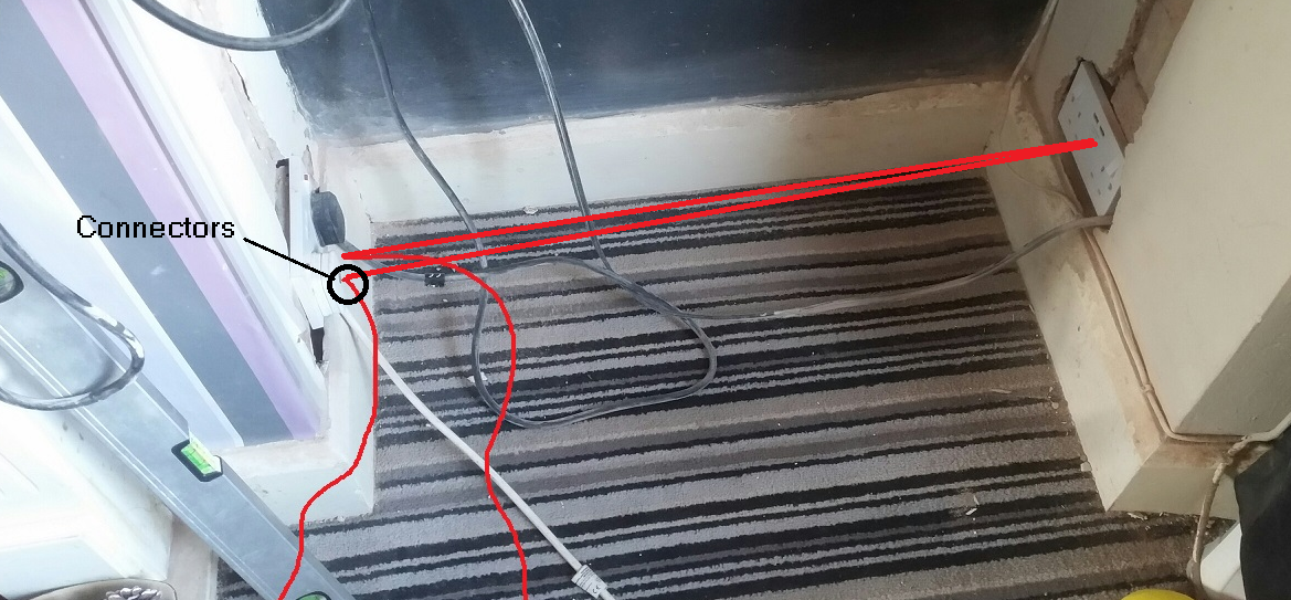

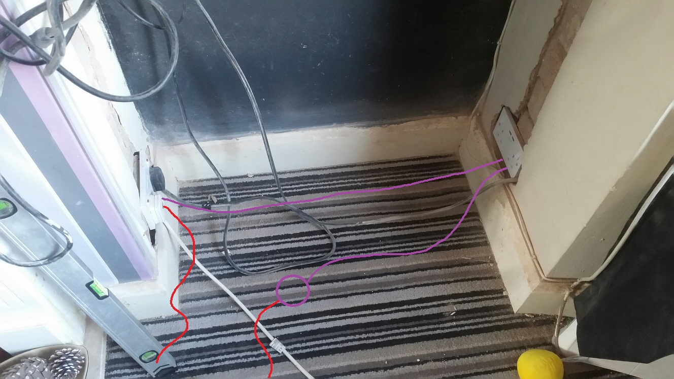

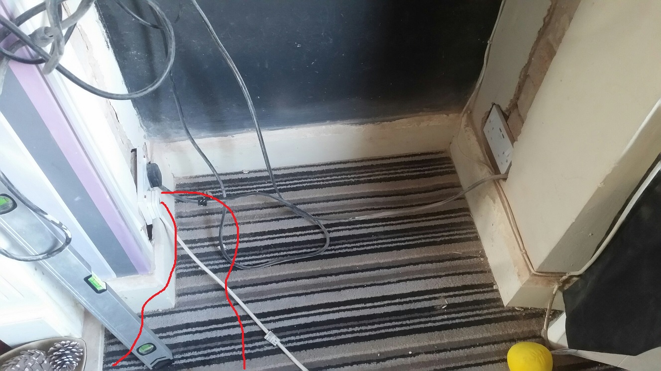

As an image example, the attached pictures show the actual sockets and the wiring that goes under the floor I have roughly drawn on.
The socket on the left is on the current ring main and the cables shown in red is roughly how they are connected. The socket on the right is the socket I want to add to the ring main.
As the existing cable won't reach to the socket on the right I was looking to insert the junction box and cabling as shown in purple.
Is this correct and I could simply use that junction box in your post, https://www.tlc-direct.co.uk/Products/ASJ803.html to do this?

You don't need a junction box.
You can just use connector blocks in the back box of the left socket.

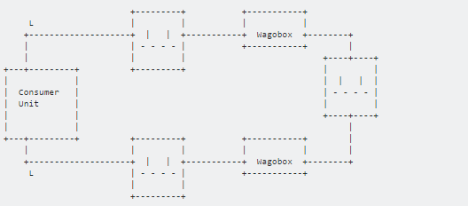

The reason I was asking two would be needed (if of course a junction box was used) is due to posts like this : https://diy.stackexchange.com/questions/102559/can-i-use-wago-connectors-to-extend-a-ring-main
Well, if you are going to do it like that then you will need two.
If you can get at the sockets then replace the cable.
If you only want to add a single socket (as diagram) then use one box and a spur.
I see they seem to be talking about 20A Wago boxes
The boxes are just containers. It depends what is in them. Are they not meaning the connectors?
I have not much experience of Wagos.
The boxes I linked to are different ratings.
These with three connectors are 32A
These with four are 20A because they will get warmer.
But the boxes are exactly the same.
