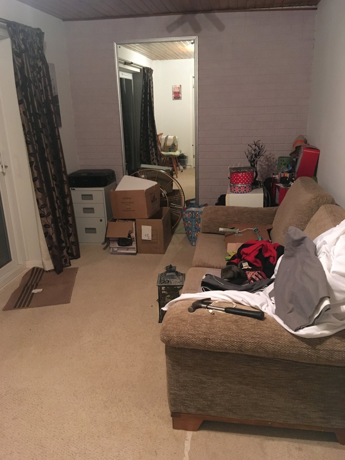

This is what we have: (see attached)

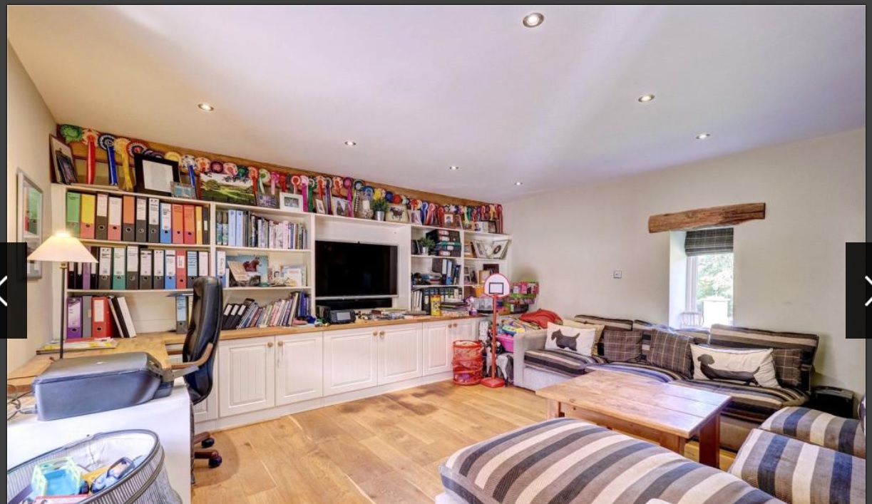

and what i'd like to create: (see second attachment)
Now obviously that's a considerably larger room but the style is ideal.
So, was intending to purchase 2 x 800mm wide kitchen base units, plonk a worktop over. This leaves me 950 in the middle (for a chair) which i'll use as deskspace.

Now, as you can see, we have a large mirror on the wall which is covering the old doorway into the garage. That wall is "I believe" single skin - might be insulated between but i've not taken the mirror off to check yet.
Also, as you can see, they went for extra trendy tongue and groove ceiling panels!! mmmmmm.....
The carpet is purely laid onto a foam underlay - direct on top of the concrete. This room previously was a garage.

I would its worth having a quick look on ebay or nextdoor -there maybe somebody taking out a kitchen that you could adapt.
Or what you are saying would work but bear in mind kitchen cabinets are designed to be 860mm high before worktop. The cabinets without the feet are usually 720mm tall -which with a worktop of say 30mm plus a small plinth of at least 10mm to keep the doors off the floor gives you a height of 760mm which is about ok for a desk, but you dont want to be any higher
Regarding floor being "carpet is purely laid onto a foam underlay - direct on top of the concrete - this room previously was a garage". That is a massive heatsink and will effect your usage of the room.
On a v tight budget I put down 25mm thick wood beams at 600mm pitch/centers and filled with 1inch thick Kingspan/Celotex. Covered with OSD or Ply sheets screwed into the 25mm thick wood.
Note that use of a vapour layer and thicker Kingspan/Celotex insulation would be best, but I was going for price and to save my freezing feet. Made a massive difference as I was no longer trying to heat the planet through the floor.
