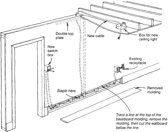

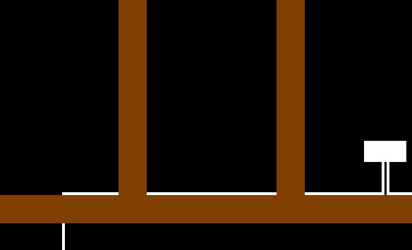

Is it done like this above? If not, then why because I would have thought this would have been the most sensible way?
All I've ever seen is the cable being run like this which i would have thought would have been more likely to be drilled through:
There is a 50mm rule. If the cable is 50 mm from the outer then some of the rules don't apply. But in the main cables are run horizontal or vertical from a visible point. So both pictures would likely fall foul of the rules.

No it is not permitted to run the cable like that. You must run cables vertically or horizontally in line with your accessory. If not, no one will know it's there, and nail through it when fitting the skirting boards.

Well that's sort of what i thought until i saw this:
And this is now why I'm confused :eek: Unless maybe this applies to a different country or for a certain accessory I don't know.

Either run the cable under the floorboards or horizontally in line with the socket.
The cable shown going from floor to ceiling isn't right if less than 50 mm from the surface either.

From the use of the words "staple" and "receptacle" and the spelling of the word "molding" (not to mention the fact we'd call it skirting, plus the odd use of a ceiling fitting box right next to a joist and the cables running an odd route, I'd say it's from the US or other country using that spelling.
Why take the lighting cable all the way down the wall to go up again?
TO AVOID ANY CONFUSION, THIS DIAGRAM IS FOR AMERICAN WIRING REGULATIONS AND IS NOT TO BE CONFUSED WITH BRITISH STANDARDS FOR WIRING
It is not permitted to run cables - or wire accessories - as per this diagram in England and Wales. If in doubt, please ask for advice here or consult a qualified electrician.
Shouldnt be able to either as there is likely to be nails at the very ends of the vertical wood so it cannot be drilled through.
