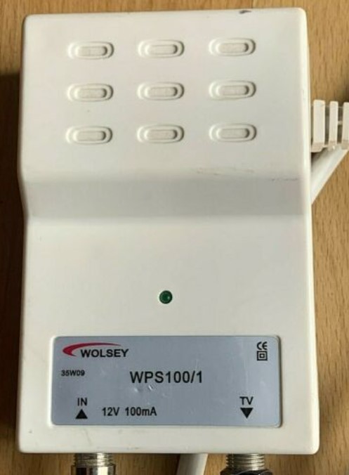

Just moved house, poor TV reception in living room. Can I move aerial signal booster?

The house we've just moved into has TV aerials in the room at the front of the house and the room at the back. We want to use the back room as a living room, but we can't get any TV signal. The room at the front of the house however has great reception, because it's got a Wolsey WSM100/1 signal booster! Can I move that signal booster to the back room to improve the reception there? And if so, how does it work?

Google doesn't recognise "Wolsey WSM100" or even just "Wolsey WSM", so unless you can post an image of its product label then I'm going to take a guess that what you've got is a Wolsey WPS100/1. Here's an image of one. Does yours look something like this?
If it does, then this isn't a booster but a power supply for a booster that's up on the roof or in the loft if that's where your aerial lives. Don't worry, lots of people mistake these things for setback signal 'boosters'. What it's actually doing is sending a low voltage power signal up the aerial cable so that the amp near the aerial doesn't need to be plugged in to the mains.

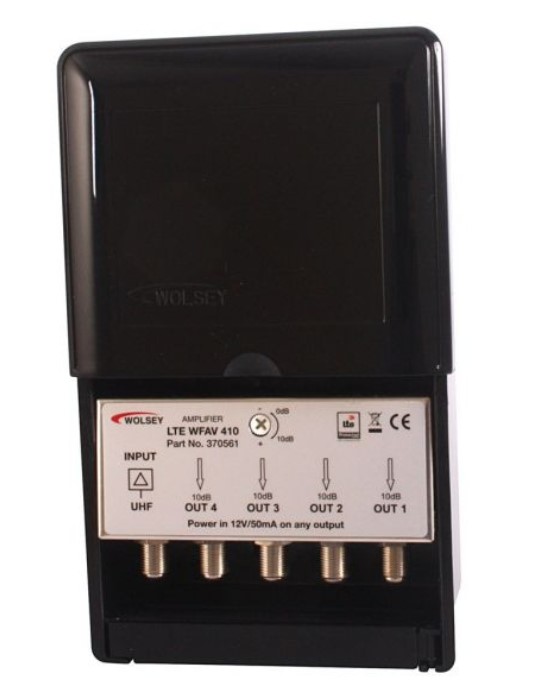

The reason then why you've got good signal at the front of the house is because of the masthead amp which is powered by what you think of as a booster. The thing up near the aerial looks something like this when the cover is raised
When the weather-proof cover is down it just looks like a box about 5" wide x 6" tall (13cm x 15cm) with some aerial cables connected to it. The one you see in the image above has an input for a TV aerial and four outputs. They do some with 6 outputs as well, so models vary but they all work with the same power supply.
The important bit of information here is that there are multiple outputs. That means if it was installed to serve all the TV points in your home then the room at the back of the house should also be connected. That means it should get just as good a signal as the front of the house. The fact that you have no reception there suggest that either it's not connected, or there's a problem with the wiring/aerial plug/aerial socket that's stopping the signal getting through.
