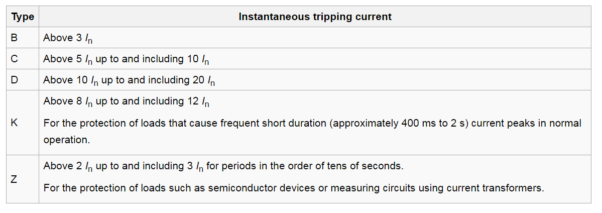

I'm trying to source a circuit breaker for an older ABB TP distribution board. My wholesaler says they are no longer made and they can not source them.
I've had a look on a well known internet auction site and found a circuit breaker which appears to be the right one, but it is labelled as K 40 A.
Does anyone have any information about these circuit breakers or understand what the labelling means?
Thanks.

If you wouldn't mind that would be great. I'm always a but weary of buying from eBay, but it looks as though a k type would be suitable.
