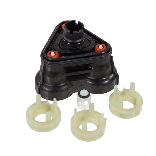

Hi, I had a problem with my pressure washer, did plenty of research then decided to try and fix it.
Its this model:
I found this video which was very helpful al though not the same model
I then found the parts on this site
Ithen bought a new cylinder head and fitted it.
It worked for a short while 30-40 mins. I stopped for a bit then went back to it, and it went back to the same original issue again. Im not sure if a cill might be lose or may be something else and it wasnt the cylinder head at all. Ive added a few videos bew if anyone can help would be greatly appreciated.
Im having trouble uploading videos will do it on ext bit as nit that tech savy
A couple of very important points regarding these plastic headed Karchers......
Never let the machine run without the lance trigger pressed - the head fractures and the machine pulses.
Ideally, use the machine for 5 minutes, and then let it rest for 5.
John
