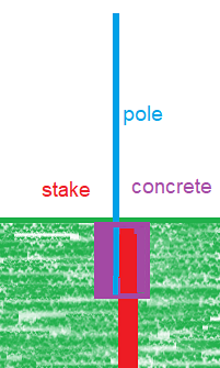

Drive a stake ( angle iron or similar rigid item ) into the ground and then add the concrete. The stake will prevent the concrete from moving in the soft top soil

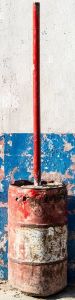

Set the post holder in a tub / bucket with concrete.
When set dig hole and place it in.
Pack around with soil.

the strongest way is to remove what you have, and make the hole a bit bigger, so long as the soil is undisturbed.
Use a trowel or a proper post hole spade so that you have a good hole in solid earth.
Then drive in some rebar or angle iron so it goes down into the soil but sticks up into the hole but not out of it.
Either sit the pole in there, or use a bit of plastic pipe big enough to be a receiver for the pole.
use postcrete which can be bulked up with bricks and check it is vertical

So the rebar would be driven pretty deep

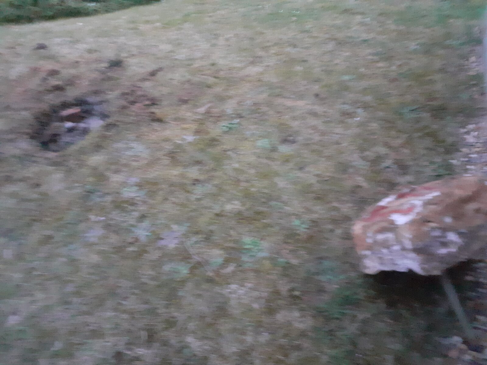

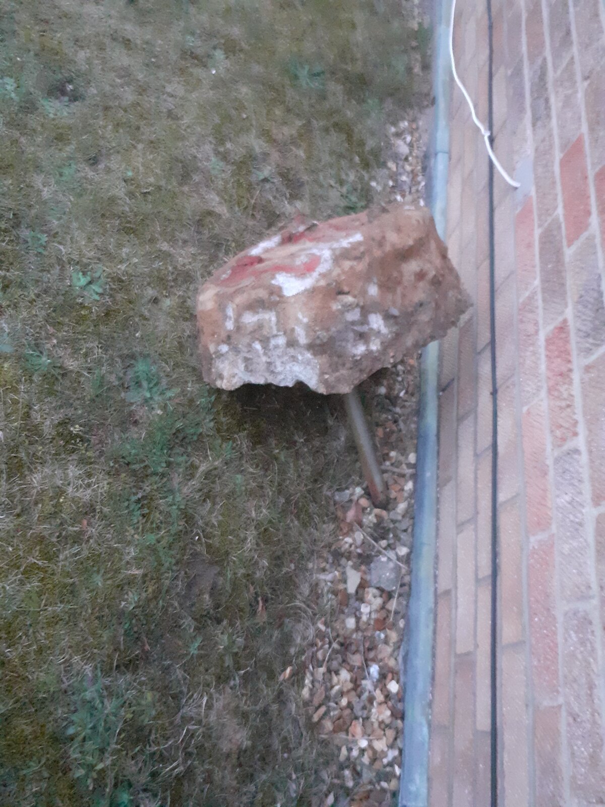

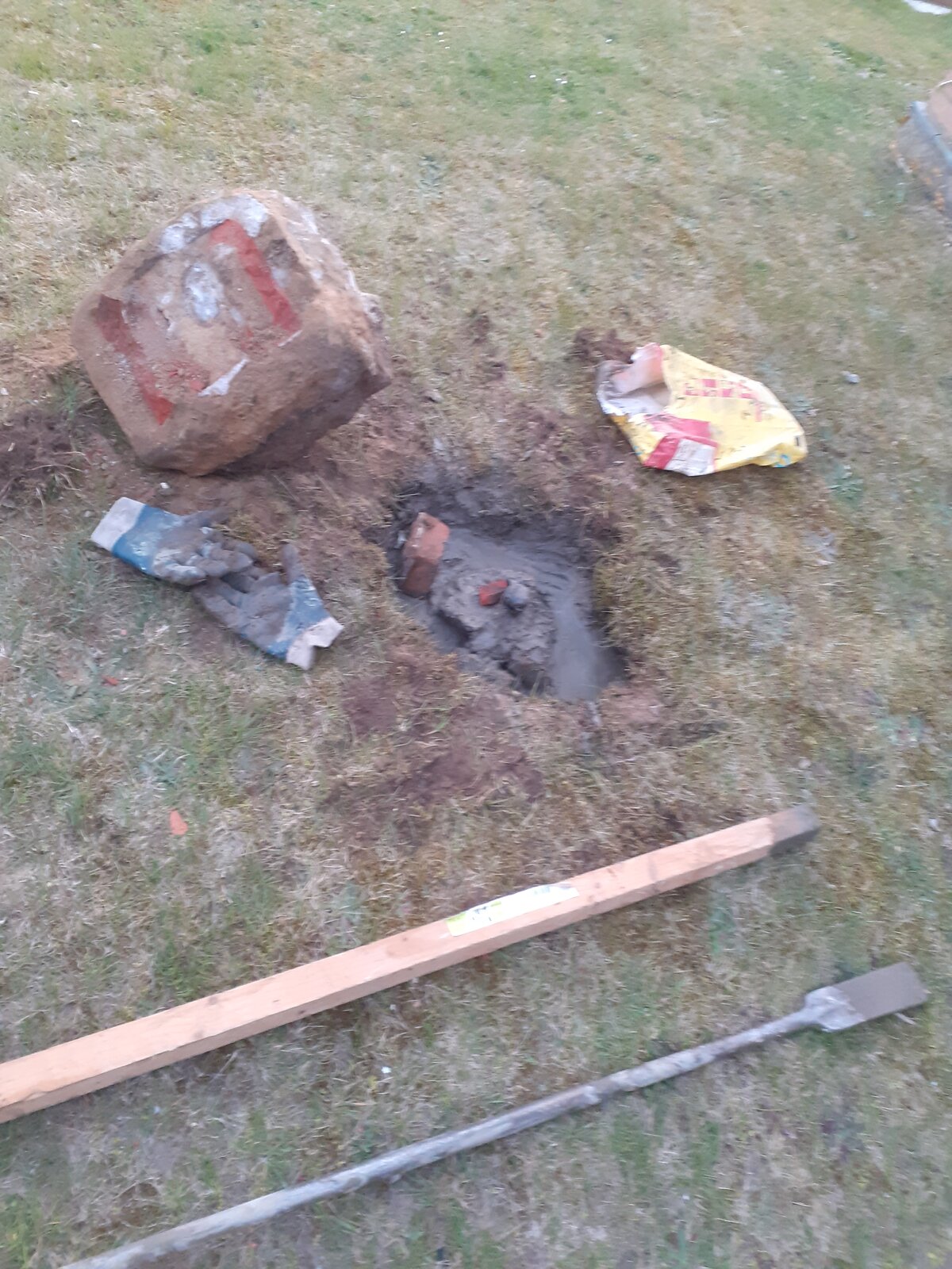

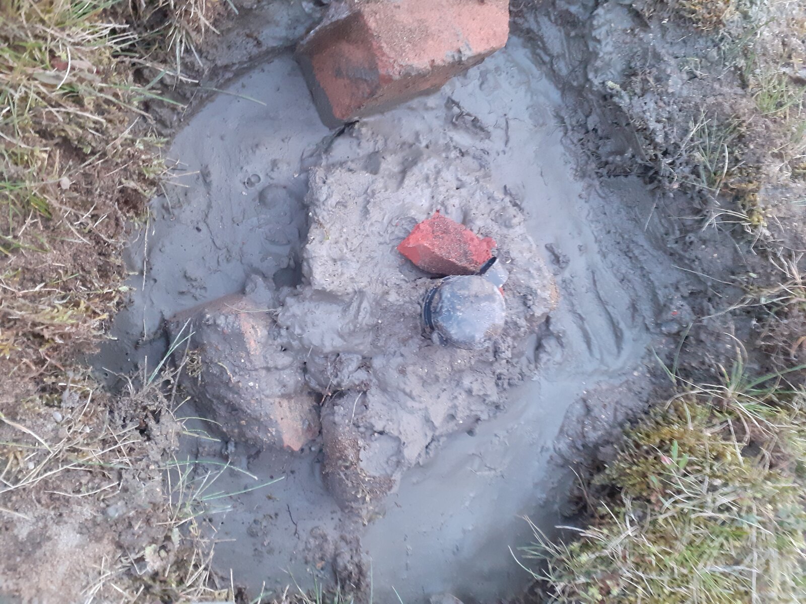

Just did another washing line in my block of flats to save money, previous one was a massive lump (in pix). We used some bricks at bottom then a plastic tube which pole slots into (got a cap on it), but not sure used enough rubble or postcrete or tube is deep enough. Quite a wide hole
