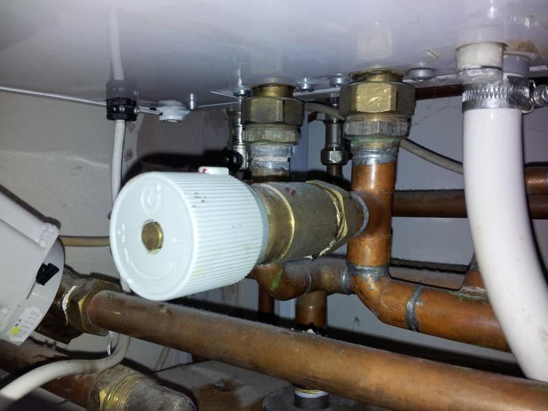

I have a Keston C25 supplying a cylinder & underfloor heating.
Both cylinder and UFH are wired together to SL on the boiler.
My cylinder thermo will call boiler and it comes and stays on until temp reached when thermo cuts live via Drayton ZA5
However my UFH will supply live to the SL on the boiler but the boiler cycles on and off for short periods such as 10 secs. Is this normal behavior and if so what is controlling this cycling ?
Thank you

Thermostat is set to 3/4 on the boiler. Doesnt make much diff where I have it but what the hell makes it a different animal when the UFH is calling it compared to the HW ?
I replaced both actuators (heads only , valves fine).
Prior to this the HW live (with UFH live disconnected) when switched off via the actuator would fire the boiler for 3 seconds every 15 mins. Valve was closed but I didnt test actuator with a meter (and its thrown) so cant be sure it was faulty actuator or boiler itself. But when I stripped actuator, micro switch (which is a sealed unit) looked fine e.g. clicked when pushed
But with UFH only connected and switched off via its own actuator it never fired boiler.
New actuators later and with each of HW and CH connected separately and with no live I have no boiler firings which is correct
but I have this dam annoying boiler cycling for the UFH..!

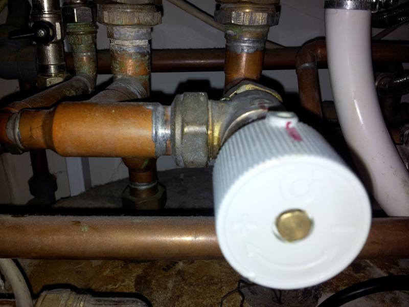

So how can I correct this (apart from new boiler lol) ?
Is it caused by the valve below not being set correct. Not sure 100% what it does myself but looks like it adjusts flow / return flow
