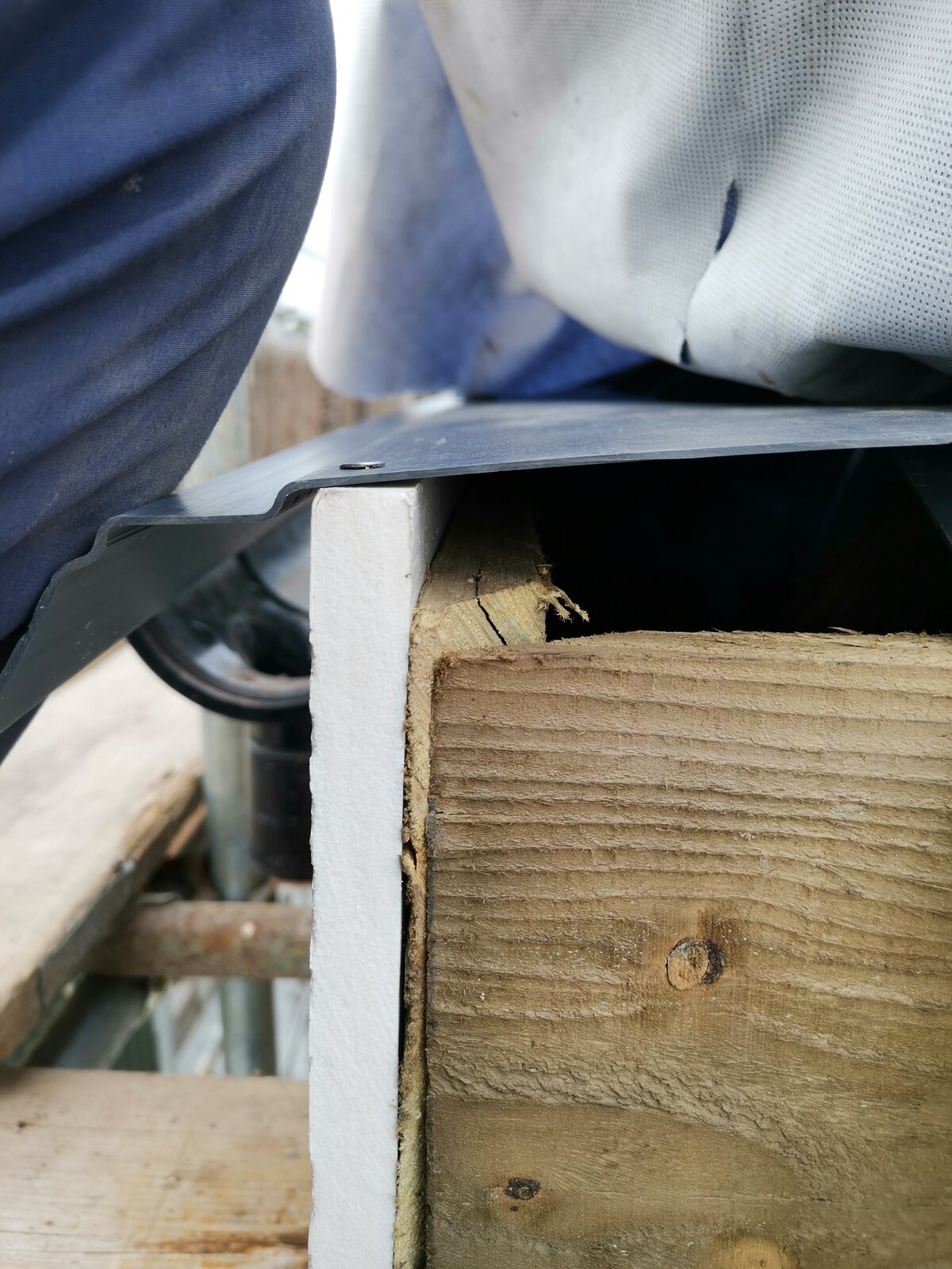

I'm happy with the job this company have done bar one thing I'm not sure about. Before they came he asked me to measure my fascia and as there was no scaff up I couldn't get to what was on the house. I had some in the garden I assumed was from when the house was done which was 190mm

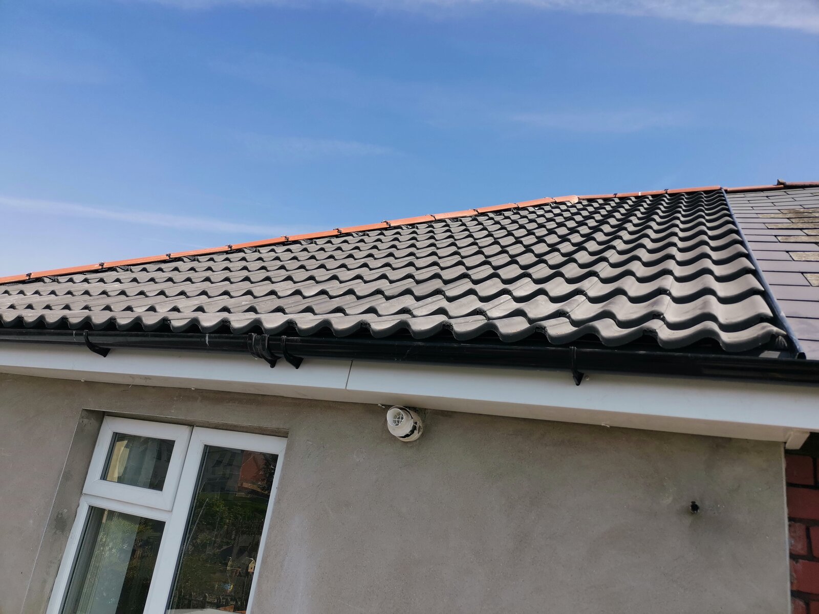

When they came to strip the roof and fascia it turned out the fascia on the house was 150mm. I told him what they'd ordered was 190mm and he said that was fine and wouldn't need cutting. This is thick stuff, maybe 12mm, so all the bird stops and eaves trays were fixed to this. This has resulted in quite a kick on the first course of tiles. Is it too much? I think when it rains hard the water might even skip over the gutters.
What are your thoughts guys?
Might be able to double up the first batten ..failing that cut the fascia
Do you think its kicking up too much then? Issue is the scaff has gone now!
I think splitting the difference by putting a slight raise on the first batten like you say might be the easiest way to go. Would that kick the second course too much though?
It's more sprocket than you should have.
Packing up is s cheat that is easy to do . You will hardly notice the second course
