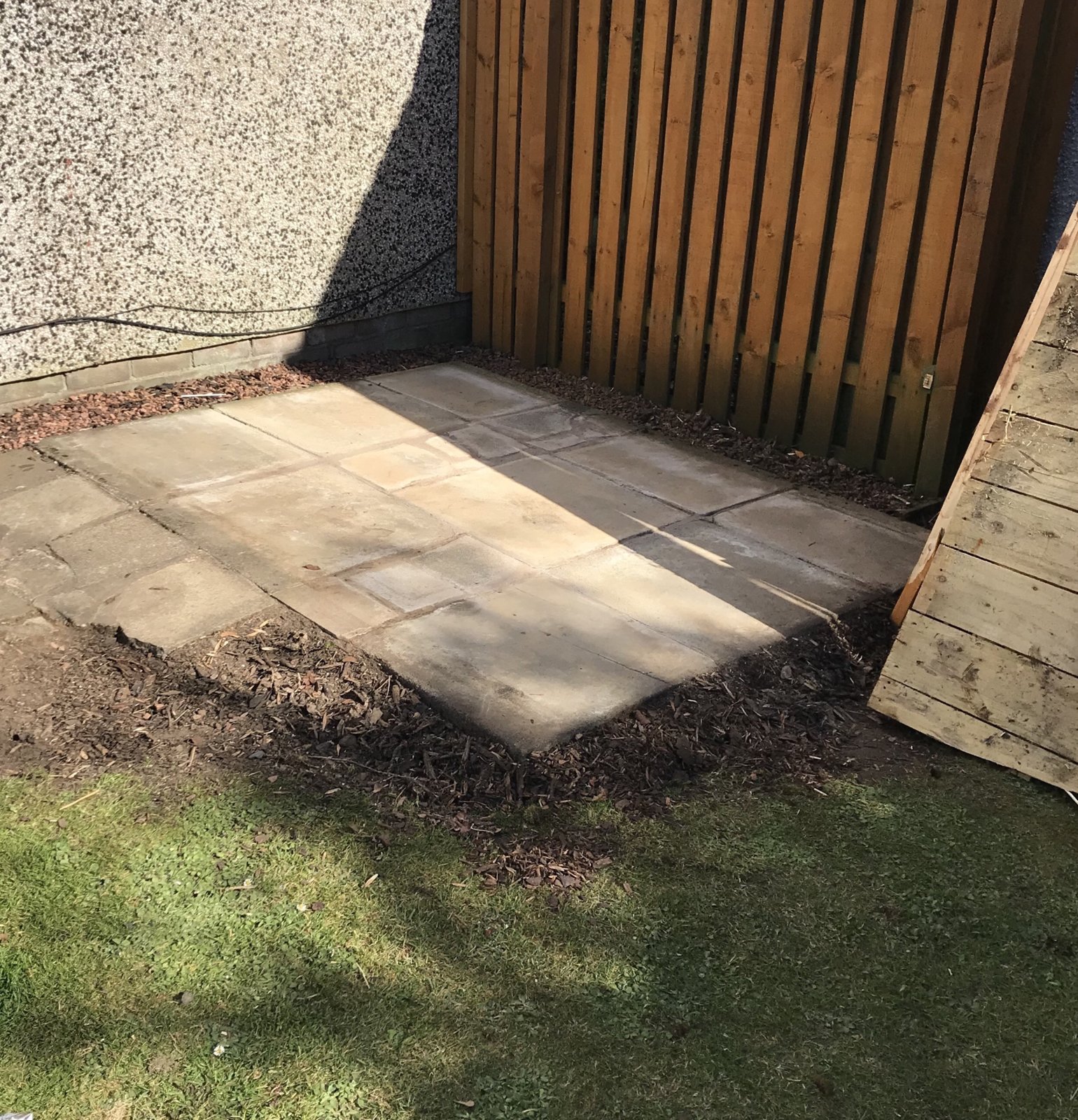

Cut a pocket into slabs and drop twist anchors in, secure with rapid set concrete or postcrete
I am going to dig the required hole for anchoring and then fill with blue circle heavy duty ready to use 20kg bag.
The below states hole should be 55cm deep x 40cm wide, on another guide it has a picture of the concrete pouring in and states 40L/80KG.
https://www.junglegym.com/blog/importance-ground-anchors-play-and-swing-sets
Looking at the fact sheet it’s 10L per 20kg bag so will need 4 bags per hole.
https://www.tarmac.com/media/959601/tds-tarmac-high-strength-40n-concrete-february-2018.pdf
Anyone got one of these Jungle Gym frames that can advise? This seems a pretty big hole and 4 bags seems a lot for this, with the pegs!
Anyone help on the above post? (y)
Heavy Duty is recommended but most vids on youtube use postcrete, also its half the price.
Anyone know if 20kg Postcrete makes 10L same as Heavy Duty?
