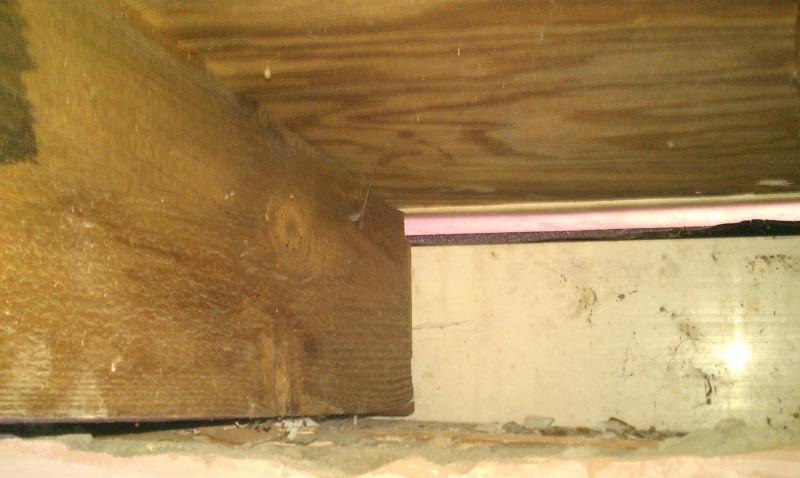

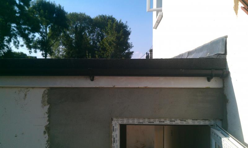

I really want to put insulation as you've suggested but I've read that cold roof insulation can cause condensation issues if I don't have enough ventilation and I should only fit it if I have ventilation from opposite sides.
I only have one side ventilation and I think that it is a bit weird as it is basically a gap between the roof and the wall which is covered with felt but allows some air to go through from the bottom as shown in the attached images.
Will it be better NOT to fit insulation with a single side ventilation and the current setup and if so what plasterboard should I use?
