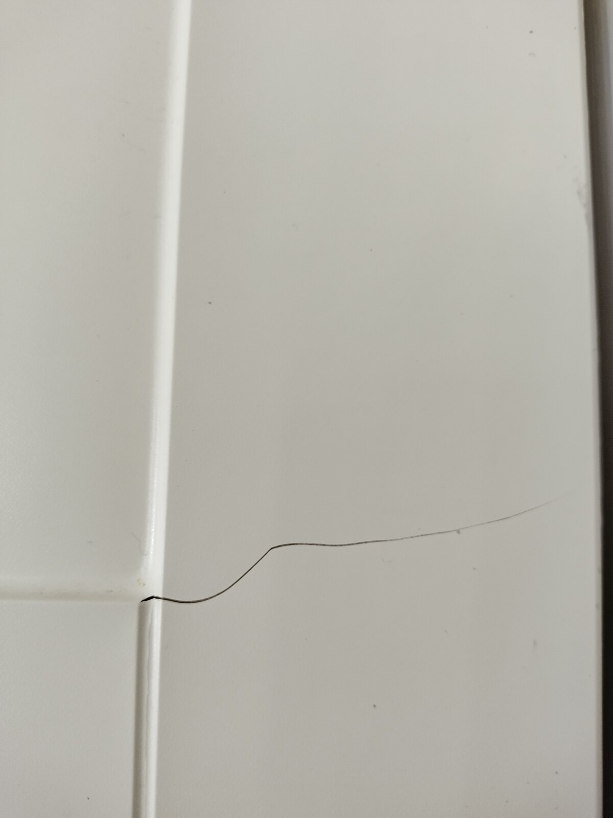

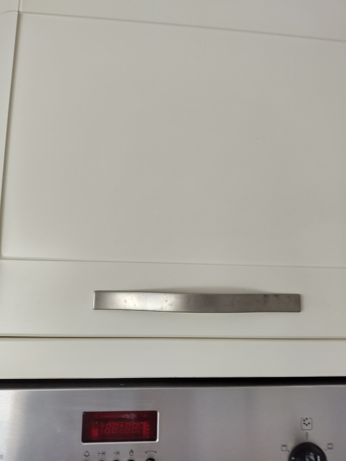

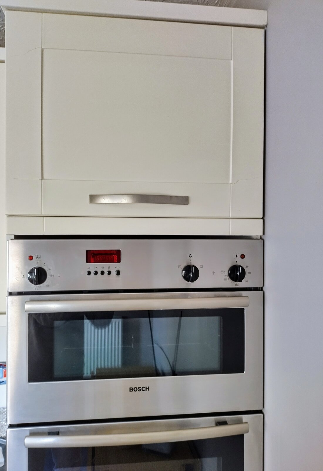

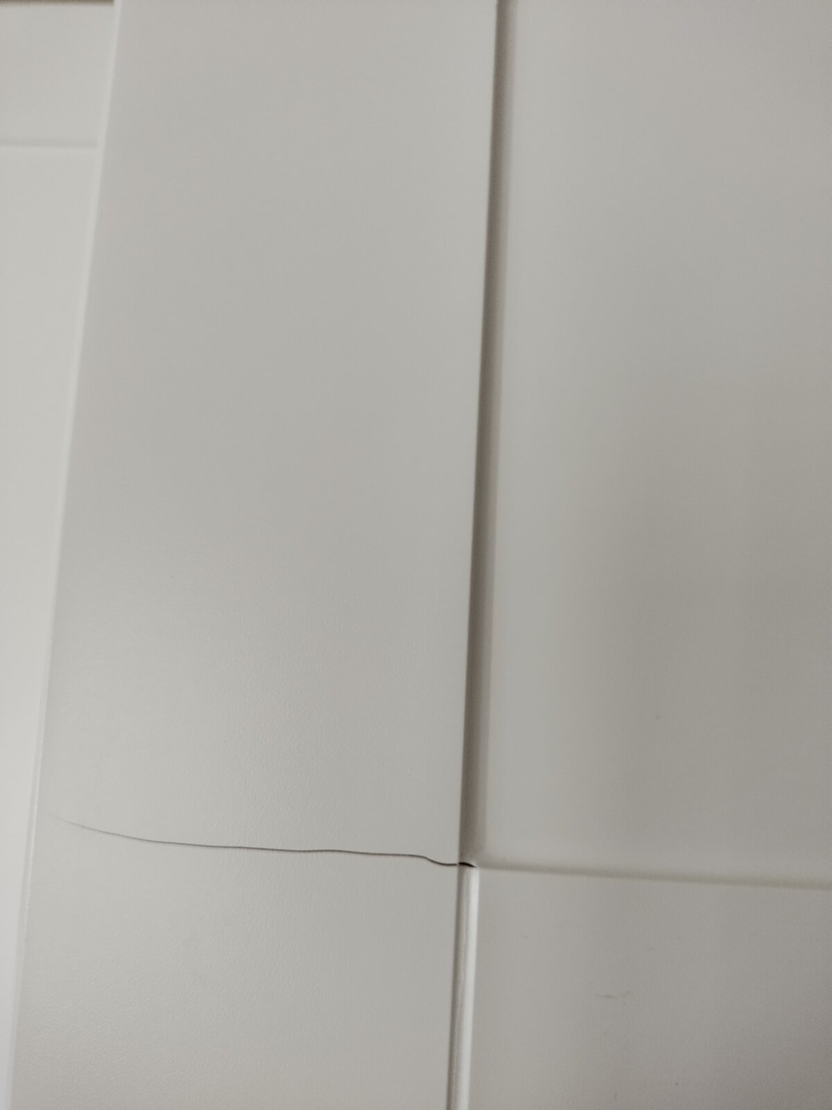

Hi we have a cupboard above our oven where unfortunately the glue has dried out. On the outside of the square shape there are now 3 hairline cracks. When touching the laminate above the handle we can feel it has blown. Please can someone advise if there is an adhesive we can put in these cracks and will hopefully fix under the laminate as well? Or if anyone has a better idea, any options very much appreciated, we can't get a full new kitchen but this doesn't look very nice! Thank you
Looks like Howdens burford cream. Is it?
Common to get laminate trouble with those doors. I have...
Replace that with a copy brought off internet. Lookup the sellers.
Other option is to strip and paint with a colour match. I have the Ral code somewhere.
Last option is to stick it back with a waterbased glue. Top quality PVA but it won't be a good fix as will show.
Thank you for your tips. We don't know what the kitchen is, Bryant Homes put it in as a new build. Thank you
Contact Bryant homes and ask.
Look up the Howdens range and the discontinued range and look at the copies online to see if they match. Ours was a brilliant copy of the burford cream as we can't see any difference.
