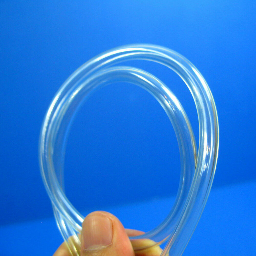

You got an example of the tubing you used on the can to assist
One end on the output tube. Taped it to some bamboo. Kitchen has an oak floor over original pine flooring. The oak only goes under the units where there's original pine flooring.
My biggest gaps were round the edge of the room and holes for services. These holes I cut hardboard and glued it it.
Hoover lots as the foam doesn't adhere to dust.
